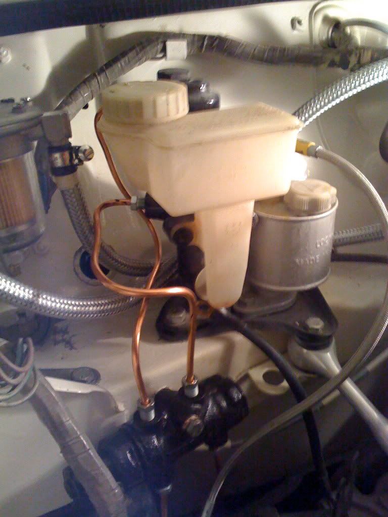

I don't know what brake pedal was on originally but it had a servo and was at a good level. Now I have tried it with the same pedal but not a servo using this master cylinder:
yes i know its the wrong way around but it fits better that way and still works.
and at the moment i've got a slightly later pedal from an old W-reg mini around 1981 and the same master cylinder. the pedal is off the same car the master cylinder is from, but the pedal still sits what i would consider miles to high.
I understand what ethel was saying but it just isn't right and i cannot put it down to a combination of wrong pedals for car etc or what?

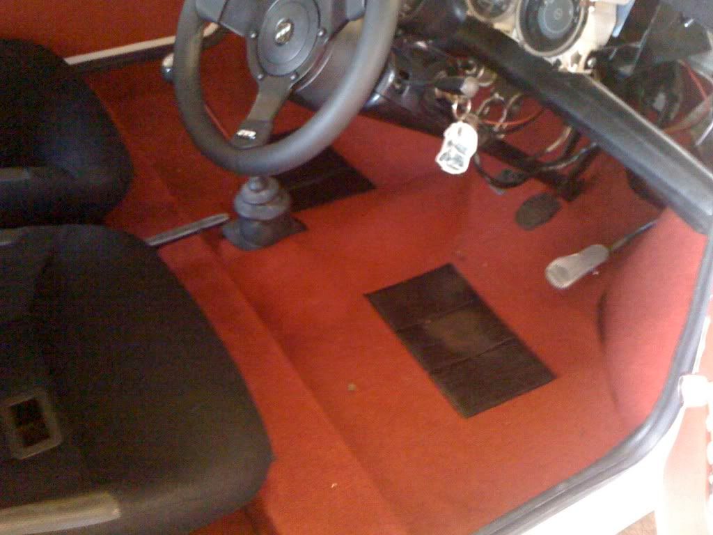

Cant really see it here but maybe gives an idea. looks much lower in the photo.
