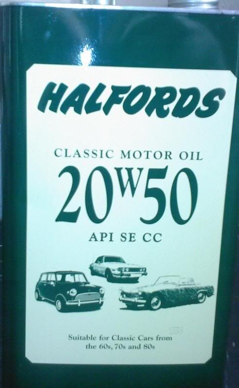

or halfords classic oil as it is the old duckhams stuff even has a pic of a mini on the tin :dontgetit:
