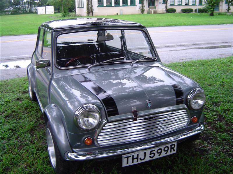

I got my Mini running again after replacing the coil, condenser, cap, rotor, HT leads, points... But it is not running up to par. around 50 you can hear it popping slightly and it is sluggish, it suddenly accelerates close to 70. I would think this is a timing issue. What is the proper procedure to time a mini? I own an inductive timing light, right now at idle i have it set just forward of the big triangle. this is with all hoses on, i read somewhere that on some cars you are supposed to disconnect the vac advance???..
Any help?
PS: If you let it idle for a long time it gets to about 220' F- It didnt do that before the issue occured.
