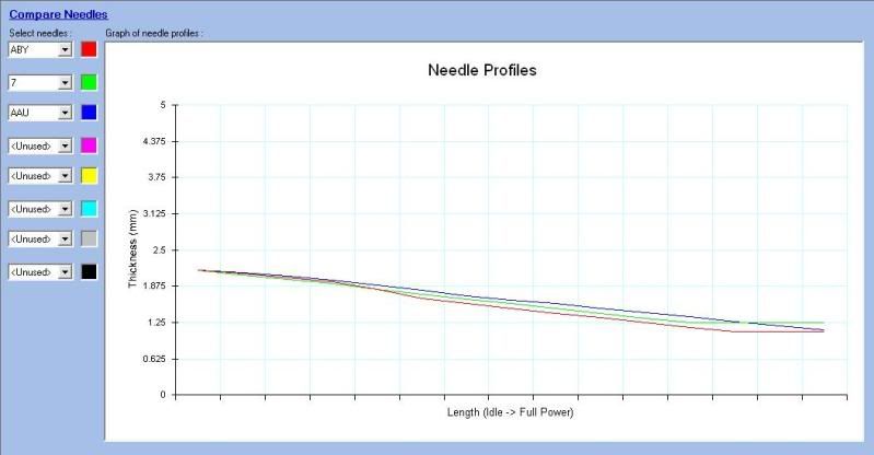

Vizard seemed to recommend a No.7 needle but I can't find this as a swinging needle, only fixed.
ABY looks a pretty close match to AAU (stage 1) and No.7, just a little richer but I guess I'll need that with the extra power...
imho win su isnt very precise.
Dont use win su comparing tool, this one is loads better:
http://www.mintylamb.co.uk/suneedle/

Mintylamb is useful for finding an alternative needle if you know where your current one is out.
