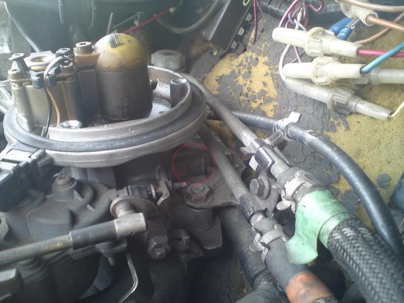

looks like thers a bit broken off but i still cannot see where it fits

common guys some help please thers only 1 place i can see it can go but wont fit as the end is broken so i need to know if its the right place
its behind the TB inline with the butterfly about an intch behind it

Looking at the car,from the front the red tube goes on the right hand side of the manifold,there are 2 tubes sticking out, you will have to remove the bracket that holds the fuel trap on to get at it.

this bit?

yup down there

and this is the end thats left

sorted thanks guys had to alter the broken bit with a drill
all done now ty

I cant imagine what you have done..... but as a suggestion I would replace all of the vac lines on the car and ALL of the elbows with new correct ones..... as the chances are every one is as perished as the one in the photo...
