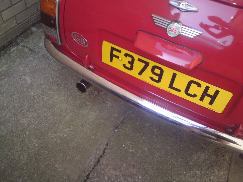

#12 AndrewJ530
AndrewJ530
  • 1,628 posts
  • Location: Middlesbrough
Posted 08 August 2009 - 04:52 PM
No it will come out underneath the rear valence at the left hand side.
Like this:
