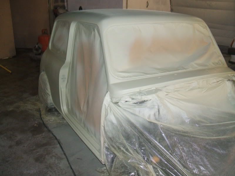

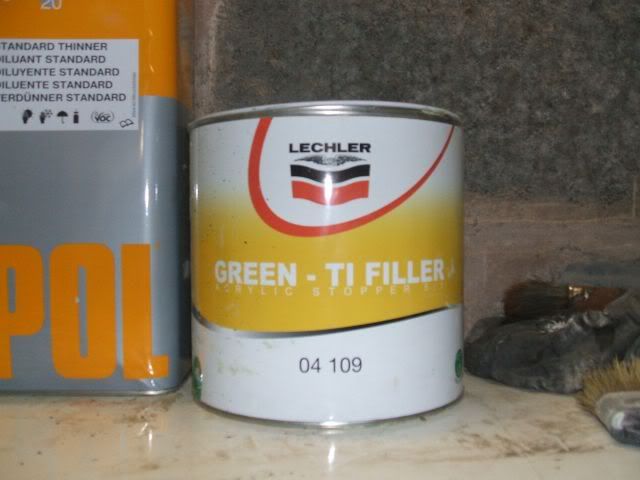

i use barcoat only if something reacts with another old layer of paint and put that down first then primer afterwards. That primer your referring to is ABSOLUTLY FANTASTIC its a very hi-build and covers creators of dints that nomral hi-build should but don't. Use it 5:1 with hardner then 10-15% 2k thinners. Altho this is a very good product look for the lechler version as i find this even better. It's called Green TI acrylic stopper 5:1. P.s Very easy to sand aswell....

cheers mini mad daps fountain of knowledge as usual, will give jawel a ring see if they have the lechler in, does that primer work as a sealer too or do you apply sealer/barcoat as well.
also what nozzle diameter do you use at 5:1 when priming. and do you use hvlp or hp gun.

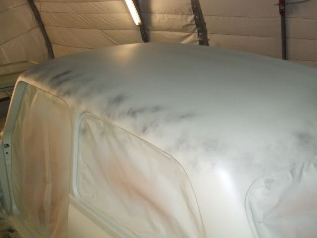

ps nice work in the picture. what grade do you sand off with after priming and do you use a da sander or hand
sorry for the list of questions sounds like my mother at although at least i didnt ask what protection you used :lol:

I spray high build primer with a 1.8 nozzle, then dust with black paint as in mini mad daps pictures & wet flat with a block & 800 grit. Shows up any marks really well & leaves it nice & smooth ready for top coat, some people use 320 on a da but I'm not keen on that.
