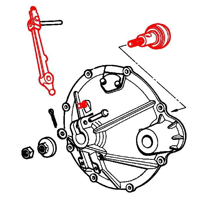

anyone know what size this bolt and nut is and where i can get it as this one knackered and non of my selection of nuts and bolts fit

If its the thing the arm is on, then its not a nut and bolt.
Its a clevis ping and split pin, you need to remove the split pin with some pliers and push the pin through the hole in the clutch case and the arm.

have been silly, are you after the size of the nut and Bolt that goes into the Clutch housing? and stops the arm going back to far?

yeah thats the one

its a UNF thread part number GHF101 (old HZS409) the nut spanner size is 7/16th the bolt is the next size up from 1/4

it is a 1/4 unf just looked.

so im looking for a 1/4 inch bolt and nut?

any good hardware shop or your mini supplies

or www.namrick.co.uk
or MiniSpares:
http://www.minispare....aspx?pid=38010
http://www.minispare....aspx?pid=37039
