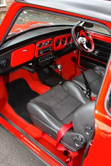

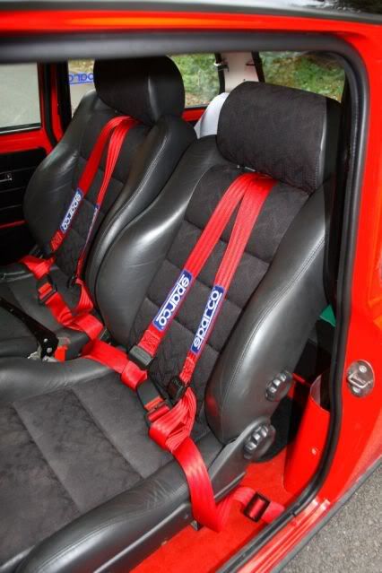

did you mean these ones? also fitted into the 214 but were flip down ones in the tomcat.? yerp they fit..lol
amazingly comfy too..

i picked those seats up for £30 from my local scrapyard and were dead easy to make fit.. i even used 2 of the original bolt holes on the tunnel.. just had to bend the tabs down to 90 degrees on the front of the tunnel and move one over slighty and reweld.. the back left hand tab (if sat in drivers seat) was just pulled abit further down and drilled through and bolted onto the tunnel and the back right i got a piece of Angle iron wleded a top onto it with a bolt going through it.. wleded it to the chair and drilled the floor for the bolt to go through...job done :dontgetit:

yep! bad isnt it..lol the only problem i had with the seats was the handbrake.. i had to raise it up 6 inches and bend the gearknob forward.. this was only because i had a cage in tho so if you dnt have a cage you can space them further apart and you dnt need to do any of that.lol
