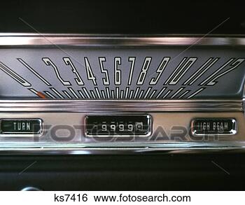

Has anyone fitted the old speedos where the needle moves along rather than around like in the link below:
http://comps.fotosea...970_~ks7416.jpg
Would it be a big of a job as I was speaking to a friend who was considering fitting something like that his car (not a Mini) and thought has anyone done it to a Mini?

like the old 500s..i hate them lol.
Honestly never seen them fitted to a mini.

what an oddity.
The proper smiths speedo for minis, looks way better. That one wont actually match the car.

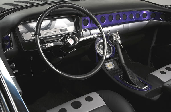

I think it would be something more along the lines of this:
http://static.summit...600/dash_01.jpg
or maybe even this?
http://www.eldobrghm...ac/IMG_2816.JPG
It's not for my mini before anyone asks I have my dials sorted.
Just thought the idea may sound interesting.
or maybe even this?
That could work really well, it would definitely be different.

Superb!
Something different!
I love these old speedos.
Both the one you've shown and the Smiths one linked above.
Many, many years ago a friend and I fitted a Volvo 144 speedo into a Mini. It was all self contained (ie speed, fuel, temp and warning lights). We made a pod for it and mounted it onto the top dash rail. The electrics were easy to sort out.
We did have a couple of problems. The fuel gauge didn't read quite right, but we soon sorted that by bending the fuel gauge arm. The speedo cable needed cutting and we soldered one half of the Volvo cable to one half of a Mini cable (the end that goes into the gearbox). The speedo did read slightly wrong, but was in my favour as it read 30 MPH when I was doing about 27 MPH.
I say go for it, be good to see something different from the 'norm'.
And as for the problems I had, try SpeedyCables who can make up the cables and calibrate it all for you.
