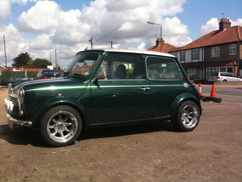

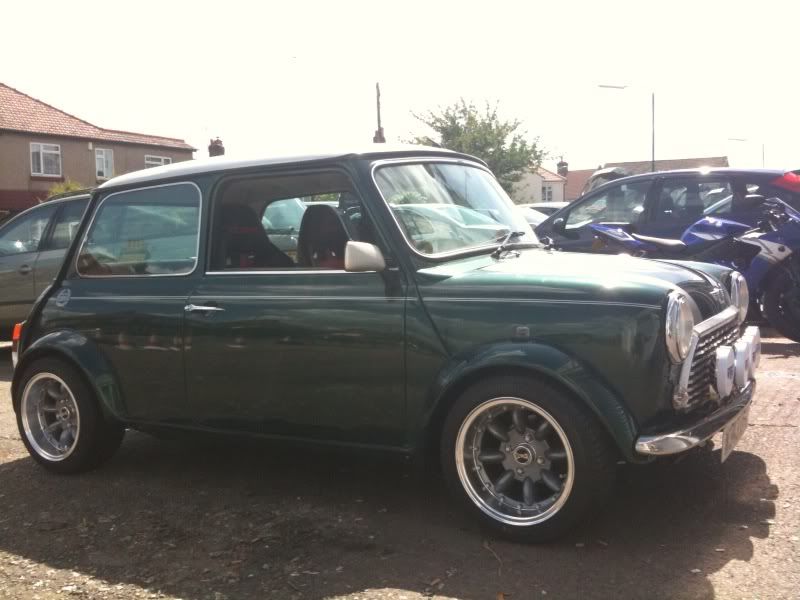

My car is very low, and has the guards cut larger already (tubbed in the rear), but I needed to trim extra at the front:
But.. they look fantastic:
Your suspension really should be up to scratch, ie good rubbers, shocks, preferrably camber sorted out properly.
