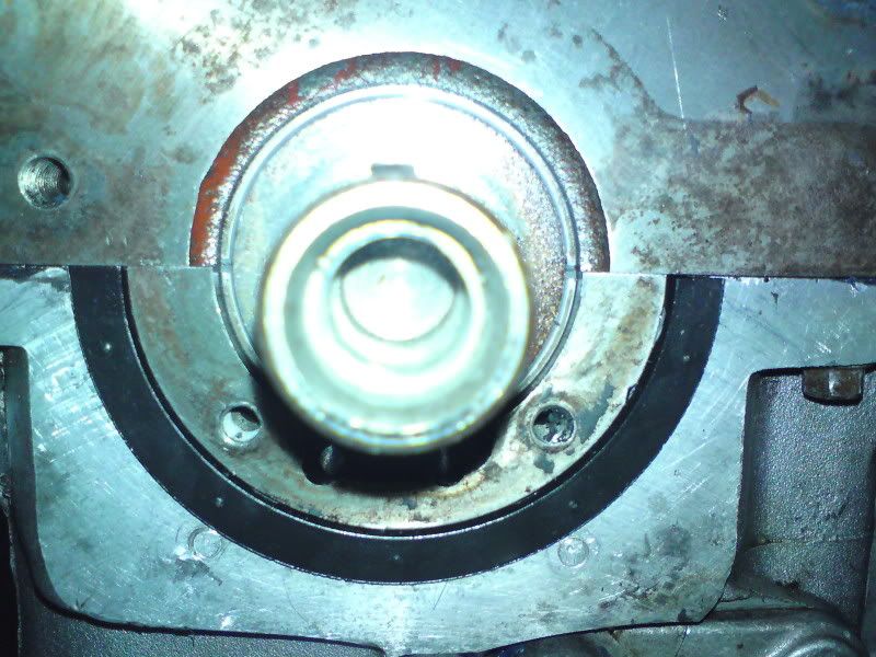

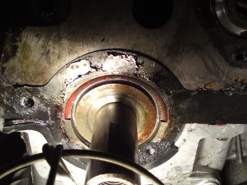

Problem solved! Got round to taking the face plate off tonight, and was greeted with this:
Looks like the half moon seal had slipped - any ideas what could have caused this? I'm very confused how it could have happened, but there's no doubt that this was the source of the oil leak!
Located a solid seal earlier in the week, and through the magic of shoving it through the hole created and pushing it through, managed to slide the old one out and the new one into place:
We shall see if it's worked by Friday when I get everything back together again, but fingers crossed...
