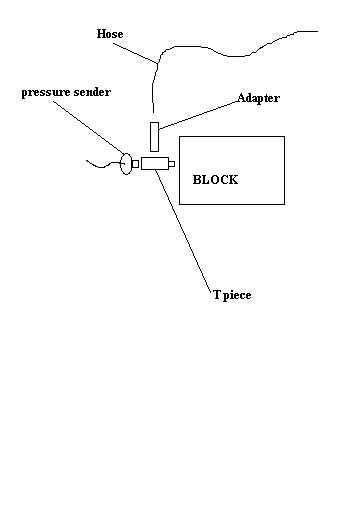

#7 stormintrooper
stormintrooper
  • 2,072 posts
Posted 02 October 2009 - 06:02 PM
like this?
#8 lrostoke
lrostoke
  • 6,923 posts
Posted 02 October 2009 - 06:04 PM
yep thats it :(
screw the T peice into the block first, get it so that the side hole is facing to the left as you look at it.
Then screw on the adaptor and pipe.

#9 L400RAS
L400RAS
  • 2,479 posts
  • Local Club: Lincolnshire Mini Owners Club
Posted 02 October 2009 - 06:05 PM
yes ,sorry for the confusion, T piece into block...
silly me.
