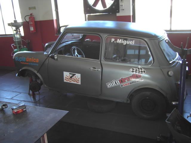

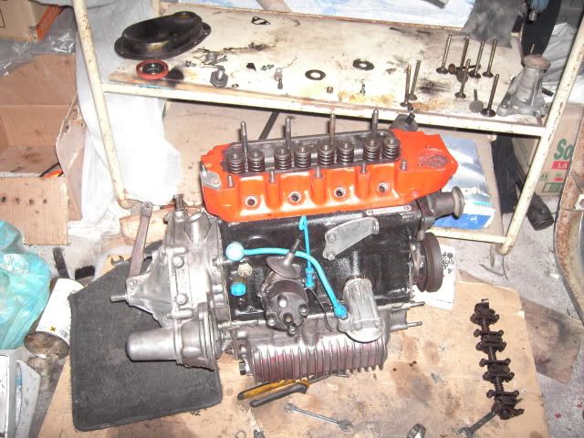

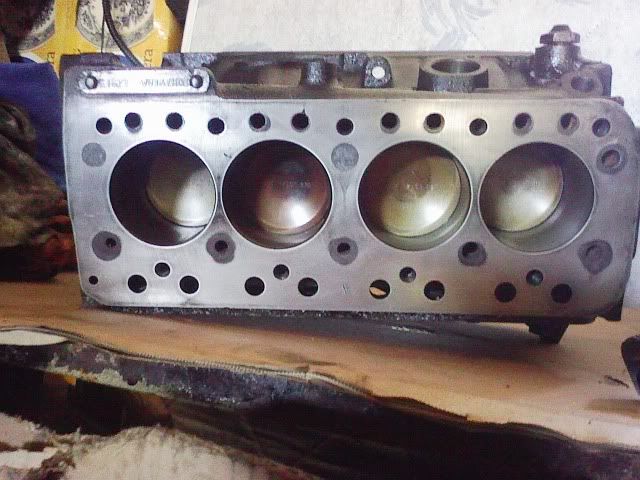

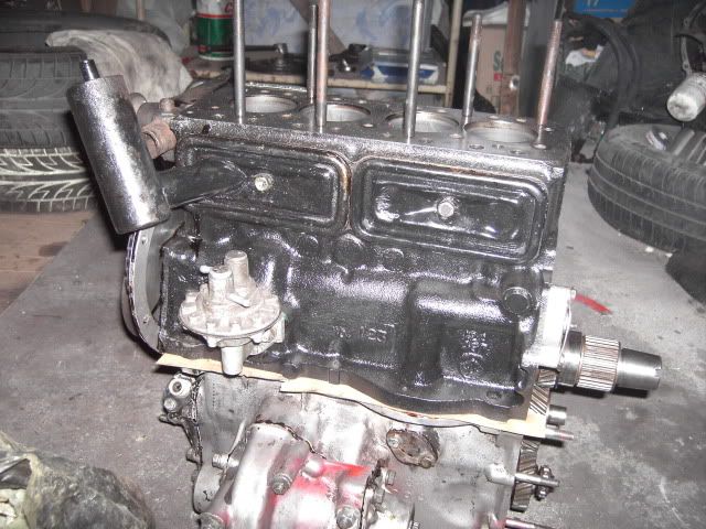

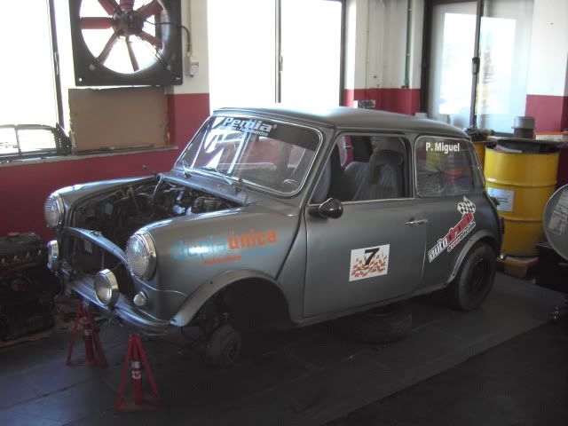

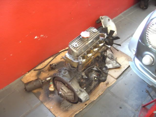

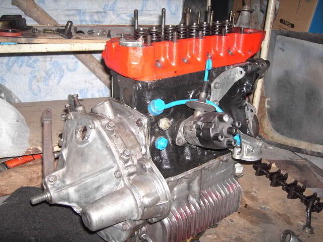

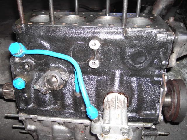

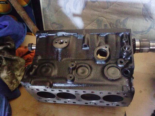

so my "project"is,a block original 1100 with MG1300 head:
mini waiting the new engine:
the old engine:
the block:

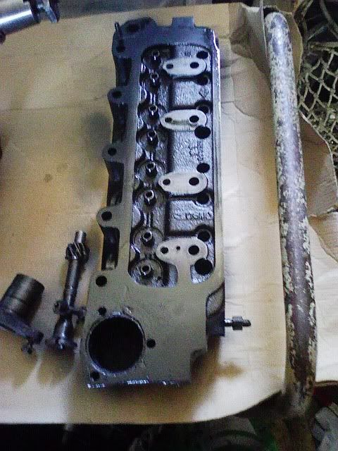

the MG 1300 head:
the complete engine:

Posted 23 October 2009 - 03:17 PM
you using a big valve head?
if are you pocketing the block?

Posted 23 October 2009 - 03:40 PM
ok how do you make it fit because ive got an 1100 and that sounds good

  • 13 posts
Posted 23 October 2009 - 07:23 PM
the engine work´s very well.
and doesnt need any modification in the block

Posted 23 October 2009 - 09:10 PM
Yes it does......don`t say we did not warn you when you find the piston has made its way into the gearbox.
not always depend on lift of the cam and where the valves have been let into the head with spacers under the valves
have seen 12g940 heads run on standard 998,s with no mods
but to get the best out of it head needs skimming to raise the compression ratio then need to mod either the head or the block

Posted 24 October 2009 - 12:45 AM
to be fair i did have a 12g940 head with a 60thou skim on a standard 998 block, there was slight marks on the block when the head was removed but it never once damaged or affected the performance other then improving on fitment
but this time i will be running a 286sp kent cam, so i think a mod made be needed, i just dont know where to get it done locally

some people are doing this modification in the block:
http://f.lourot.free...e1300sur998.pdf
but,if the cams are original (the case of my engine), i think,that is not necessary do that to the block.Now if the cams is another i belive, is necessary to do this modification
