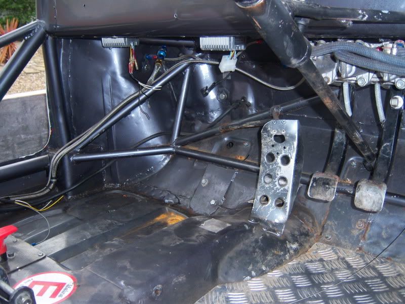

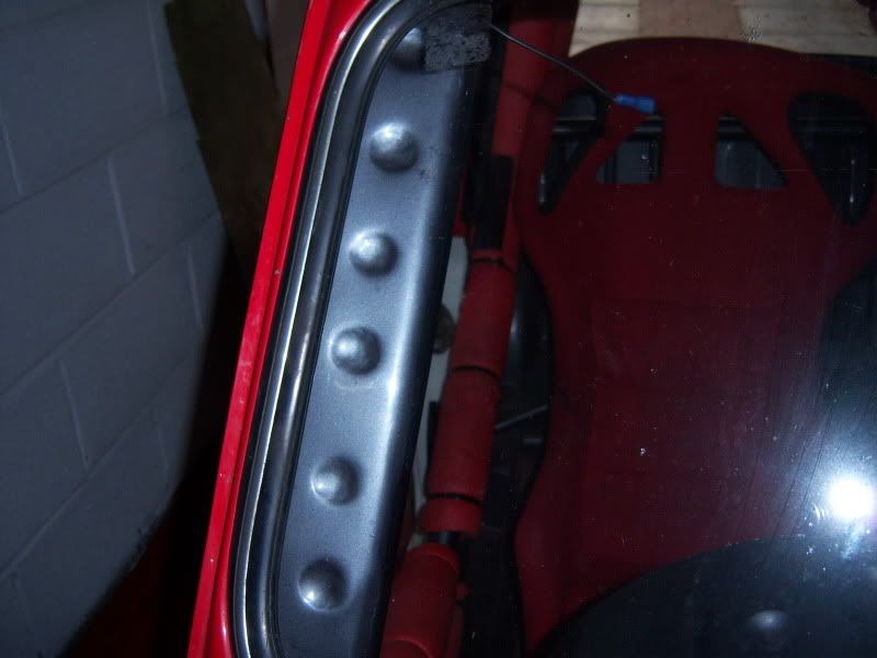

Posted 29 October 2009 - 04:49 PM
iv the only one of my cage as far as i know, built by roll centre in the UK
the rear post then goes through the bulk head and mounts fo the rear arch.
incoperating seat mounts
front section, floor brace, dash brace
the cage is attached to the cage on the A,B and C pillers, incoperate a harness bar if your going through the trouble and you cant see it in those pics but a diagonal has been added (previous owner had stupidly cut it out)

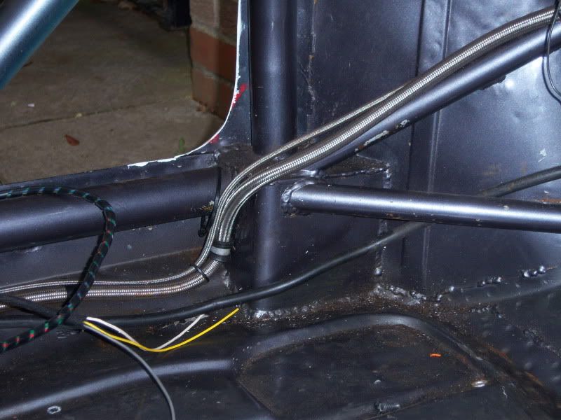

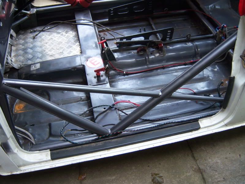

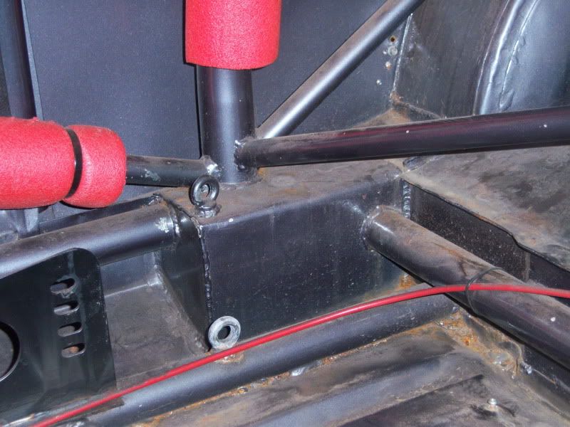

#7 rosco454
rosco454
  • 908 posts
Posted 29 October 2009 - 09:49 PM
This is mine.It mounts in the usual places on the front and rear floor but goes through the rear bulkhead to the arches,through the front and into the bulkhead,ties in on the a & b pillars as well as along the inner sills,cross member and onto the heel board.It also mounts onto strengthened areas on the toeboard.

thanks for all the info/pictures, do appreciate it... also, nice pedal assembly, where do get something like that?
#13 rosco454
rosco454
  • 908 posts
Posted 30 October 2009 - 09:31 PM
Im not sure on the make of the pedal box,it was in the car when i bought it.The only thing i know is that it uses separate front and rear brake master cylinders as well as a third for the clutch.It uses girling master cylinders but apart from that i know very little.I will be taking it out next week so i can get some pics if you like?
Quite a few companies do similar things,kad do a bias box but it sits in the engine bay.There are plenty out there that mount up like mine,have a look for tilton,optimum balance etc and theres a few on ebay as well
