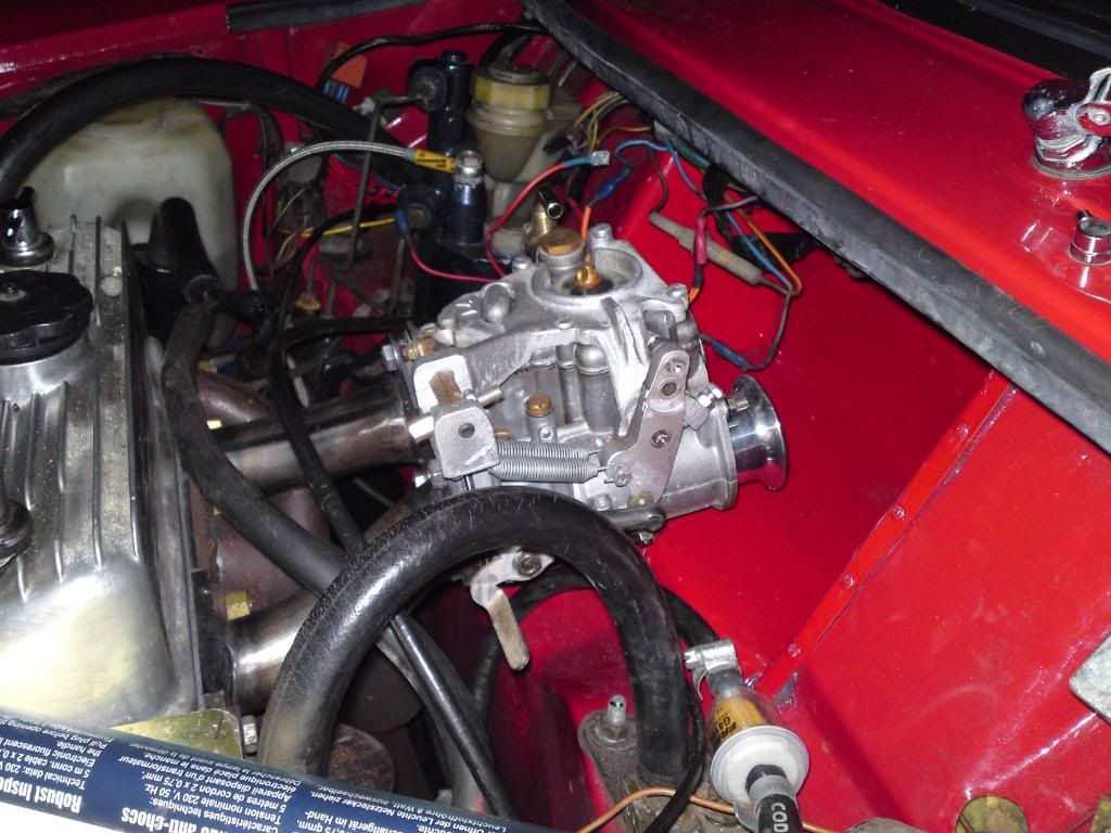

I would go for either single HIF44 - or twin HIF 38s. You could consider twin HIF44s - but really a bit of an overkill for your mild engine spec. Weber 40 can't take big enough chokes to feed a 1340 engine - so would need to be the 45 - be ready to go deaf, and to spend all your money at the petrol pumps!
Afraid i must disagree with that, I run a weber 40 on my 1330 with Morspeed Ph3 cam and it runs fine. Even the weber tuning specialist didn't mention it not coping with big enough chokes!! From memory it runs 36mm chokes but I can't remember to be honest.
But have to admit the weber sounds truly awesome!! Not that deafening either and I have a weber box sitting an inch behind my dash!!
