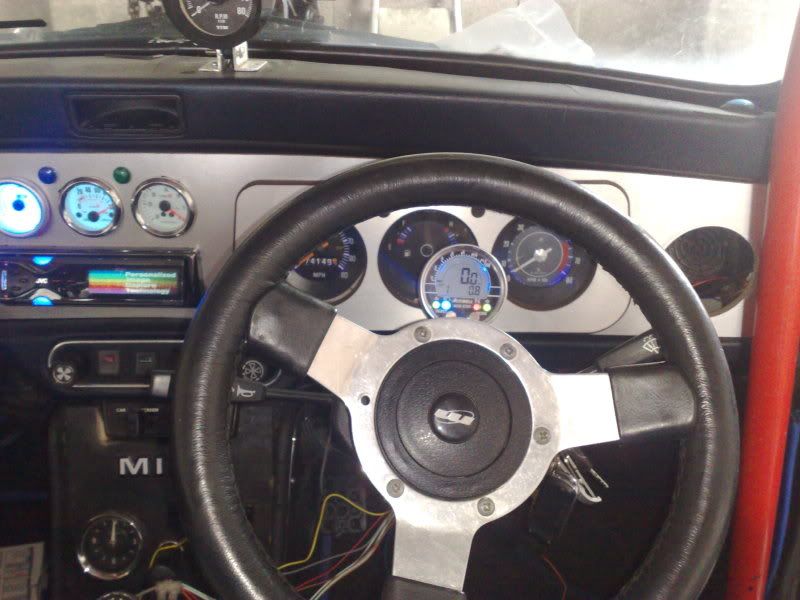

Quite easy to fit, just follow the instruction. Im using thr magnetic sensor with the magnet attatched to the rear drum.
It did work well, but now it gets confused, between 42 and 51 mph, it just sais what ever speed it feels like.
Is nice having trip counters though, makes working out mpg a bit easier. Also alot easier to read at night than the old mini clocks.
I suspect the problem you are experiencing is what I have cautioned about on previous digital gauge threads. The simple magnetic pickups are based on reed switches. Reed switches are going to cause you problems if they are mounted in a way that excites their natural frequency. There's no way for me to predict what that would be. However, consider for a moment that mounting your setup on a rear drum requires that the pickup also be mounted off of the radius arm which will be subject to a lot of vibration.
As a test, if you can "beef up" whatever method you used to mount your pickup you may find you can make the 42 to 51 MPH problem go away... or shift it to a lower speed. By adding mass you can lower the frequency of the system a bit. I had to make a much stiffer mounting bracket for the reed switch pickup on my car's bike speedo.
An alternative would be to buy one of those ACE-S2 pickups linked above. The description says that they are Hall Effect sensors. They use a different technology for switching but they are still basically magnetic. The Hall Effect sensor will be a 3-wire device so it will require a power source in addition to providing the signal for your digital instrument. The important thing is that it won't have a resonant frequency that will upset your gauge display.

This is how I mounted the bracket. I thought it was a bit odd how it used too work perfectly, but now it's not so great. The bolts and screws holding it in place are all still tight. So you think I should re-make the bracket?
