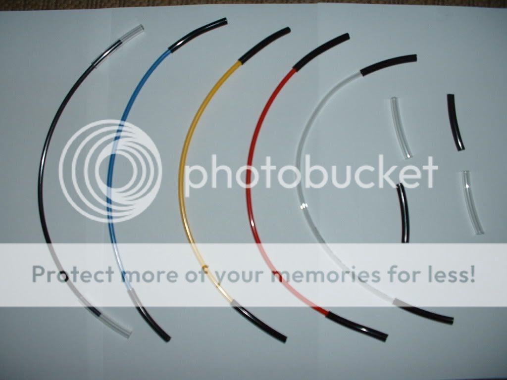

Its your vacuum advance hose, basically it adjusts the ignition timing as the engine revs increase.
(now I wonder where you could find some coloured ones for just £3 posted??)
Hint......(its me!!)

loving the coloured ones shifty!!
#5
Posted 22 November 2009 - 03:22 PM
tHANKS SHIFTY HOW DO I GO ABOUT GETTING A BLUE ONE.???
