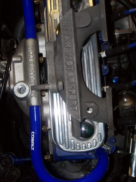

Here you can see the difference in the holes in each manifold. Ignore the clampless hoses on the new one...I am hardly finished with the engine bay. :(

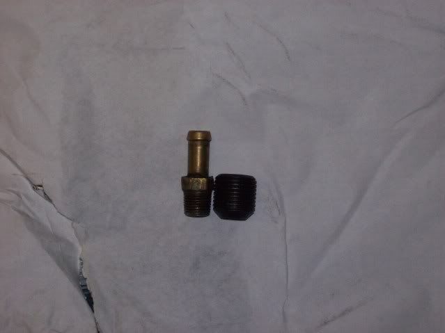

Here you can see the difference in the plug that was in the Minispares manifold and the old brass connector that was in the old one.
#8 mars red mike
mars red mike
  • 1,500 posts
Posted 30 November 2009 - 08:37 PM
I am assumin that your old servo intake pipe was a push fit onto the brass union? If so, you will need to get the end piece and banjo bolt from a late mini servo intake pipe and attach it to your existing intake hose. Click the link below to see what I mean
http://www.minispare...ty=pb&pid=41698
The bit you need is the brass coloured bit at the end of the pipe on the right hand side. You will also need a banjo bolt that goes through it to screw into the inlet manifold and two copper sealing washers. I cant find them seperate to the pipe on Minispares site but ask them anyway they might be able to get you one.

#9 IFlingPoo
IFlingPoo
  • 213 posts
Posted 30 November 2009 - 08:41 PM
Nice, thanks. At least I now know what I need to connect it properly. :(
As far as Ii can tell, it is...aside from the resevoir you have. Mine is just the yellowed plastic one. Other than that, it appears to be the same.
