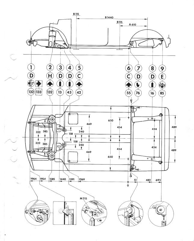

Any bodyshop equpiied with a jig would be able to do it, you get less jig work these days, often if a car needs jigging then it's written off.
You need to leave the subframes in. This picture may be of use..

Panelbeaterpeter - Thats a brilliant diagram where did you get that from?

Posted 11 December 2009 - 09:59 PM
The depths of my PC!

Posted 12 December 2009 - 12:17 AM
I've now saved it to my memory stick to for later reference >_< Cheers
