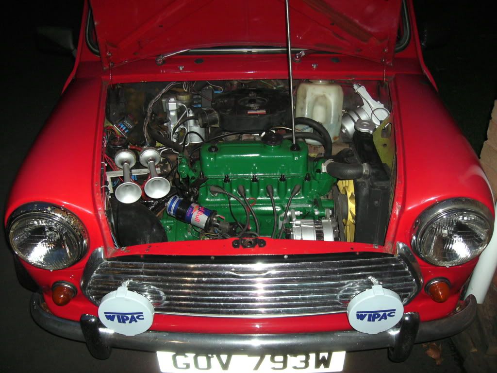

Don't bother buying brackets-all I did with my lights is got some long jubilee clips and cut them so that you are left with the long threaded strip and the little screw. Drill a hole in the part with the screw and attach it to the top of the spotlight (there is usually a screw in the top of the lights)
Then with the long threaded piece drill a hole in the end of that and thread it through the grill and screw it to the bonnet slam panel.
Then rejoin the jubilee clip as normal and tighten it up-this will allow you to adjust the angle of the light.
If what I have just said is a load of rubbish and has confused you (which it probably has lol) just ask me and I'll take some more pictures for you
You can just see the cut jubilee clips on top of the spot lights and where they attach to the bonnet slam panel. Simple but effective. They hold the lights very firmly and also help to hold the wiring loom in place

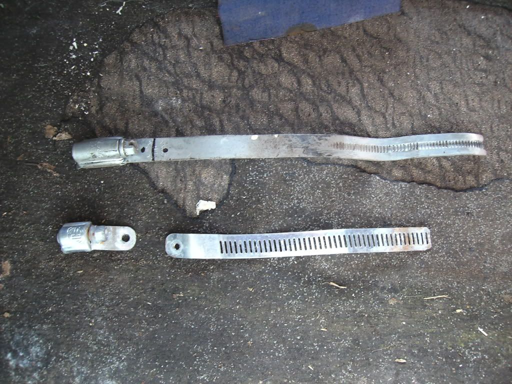

This is how I braced my spot lights to stop them moving.
First I got a long jubilee clip, cut it and drilled it like this...

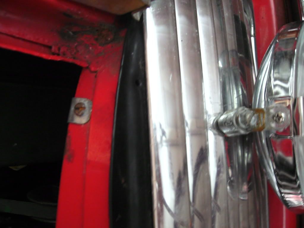

Then take the screw out of the top of the spotlight and fix the small part of the jubilee clip to it like this...

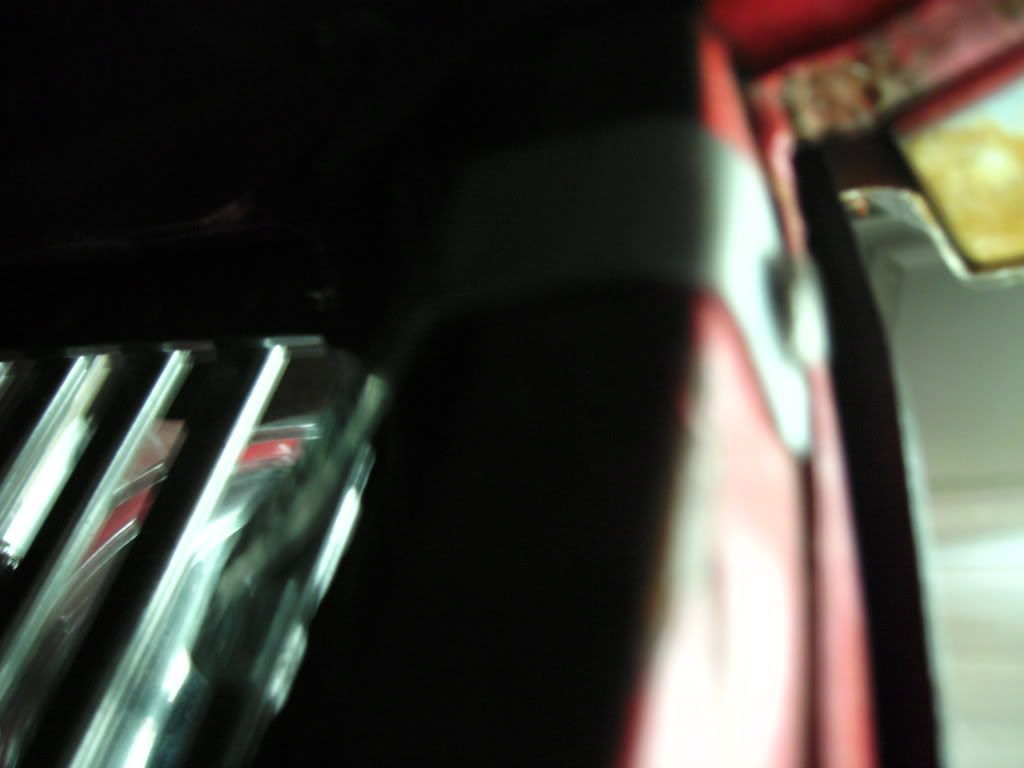

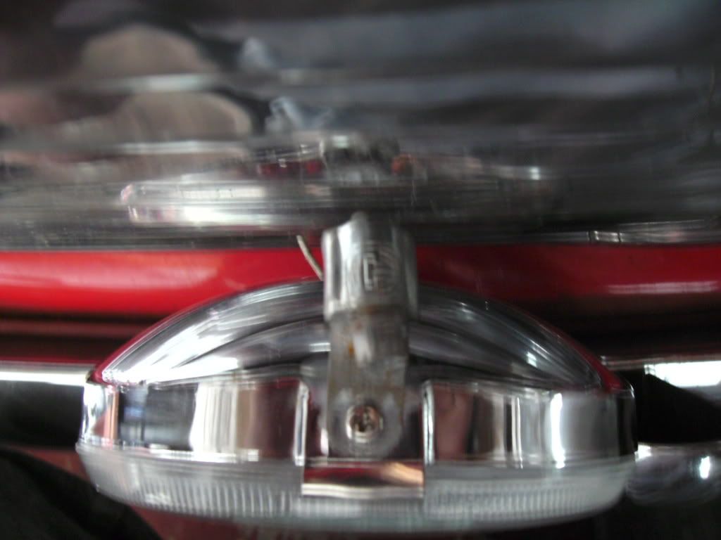

Then drill a small hole in the slam panel (be careful as the wiring loom is under here) and fix the larger part of the jubilee clip to it, using a self tapping screw. Then bend the clip round the slam panel and through the grill into the screw part of the jubilee clip like this...
(sorry about poor pictures!!)
All you do then is tighten or loosen the jubilee clip to adjust the bean of the light up or down :)
I HOPE that has cleared up any confusion! Any queries just ask (im not the best at explaining things!! LOL)
