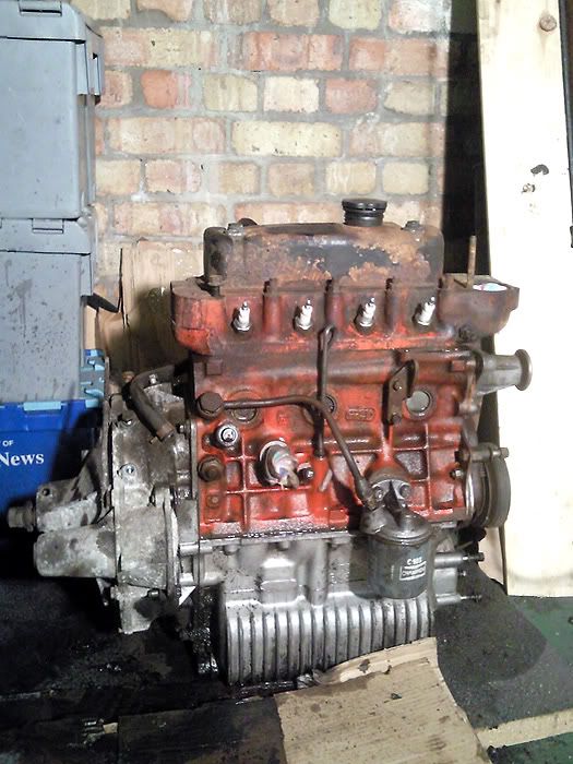

Ive got myself a decent metro 1.3 HLE engine to put into my project, and have a few questions about it.

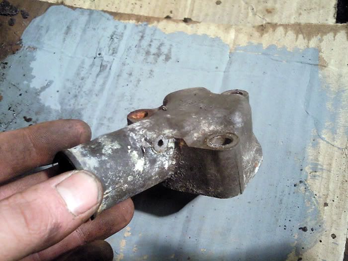

The cooling system is confusing me at the minute, can i take the thermostat housing off a standard 998cc, or do I have to stick with the sandwich plate arragement.
Im wondering this, as in my haste ive snapped the little nozzle off (see photo). I cant remeber what this little nozzle led too, im presuming an expansion tank in the metro? Is this litle nozzle required on minis, could it be tig welded closed and forgotten about?

I think because of the front mount rad - it needed an expansion tank - and a filling point high up. Just drill out the hole on the head - and fit the heater valve there - the two little holes should already be threaded.

If i remember correctly the standard 998 engine that ive taken out has the heater valve inlne with one of the hoses, not off the LHS on the head itself.

Aye - but the hose will fit on the head!
