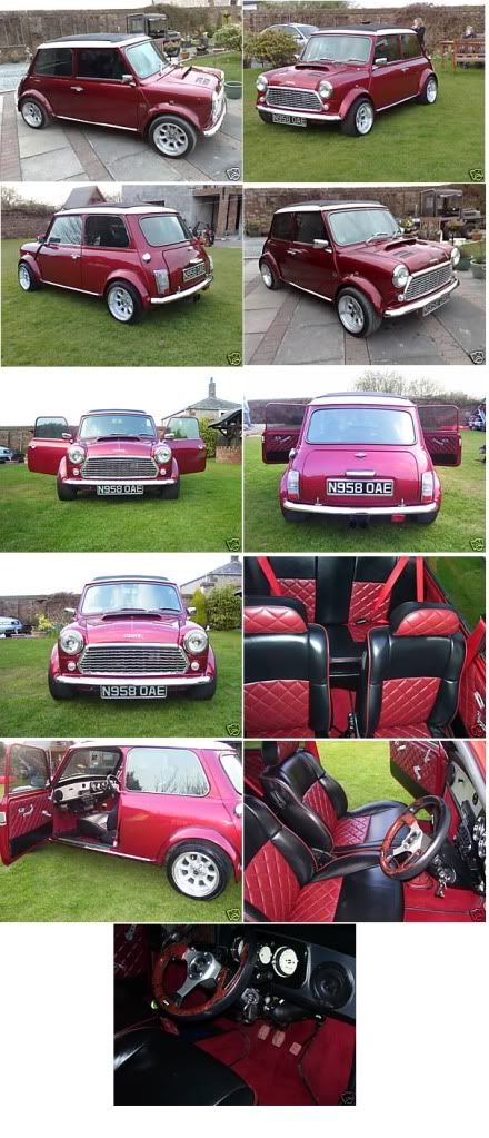

#10 1995 MK2 IOM
1995 MK2 IOM
  • 810 posts
  • Local Club: NO CLUB HERE.... YET
Posted 31 January 2010 - 10:34 PM
these are 13 x 7s
I quite like them... but they do stick out a bit... just have to watch those kerbs!
