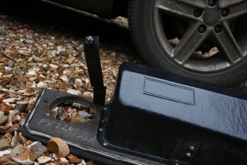

Heres what the dash looks like:

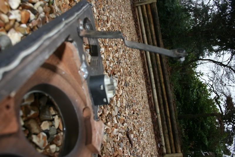

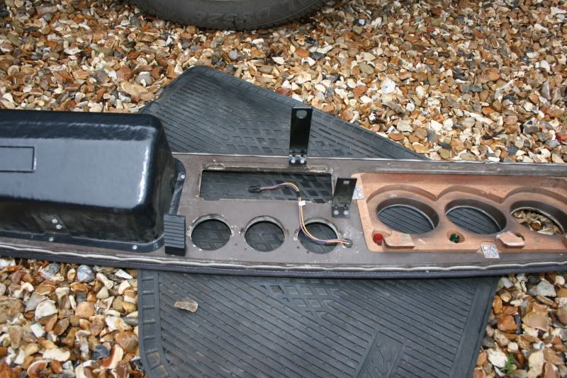

I only have two brackets on the dashboard, here's what that looks like:
Posted Image ^^These seem to get in the way?
And another thing is this end doesn't seem to fit like the other end, is there some way to loosen the top padded dash rail thing? (sorry for lack of correct terminology :thumbsup: )

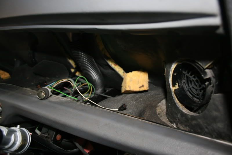

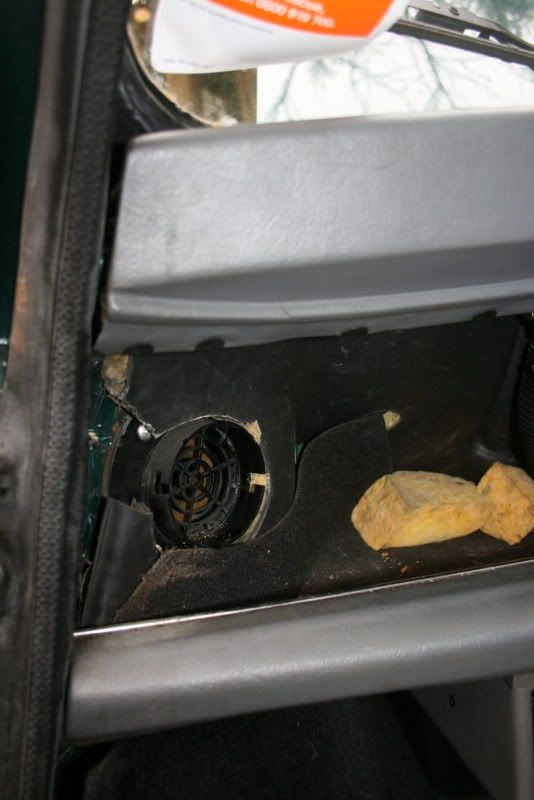

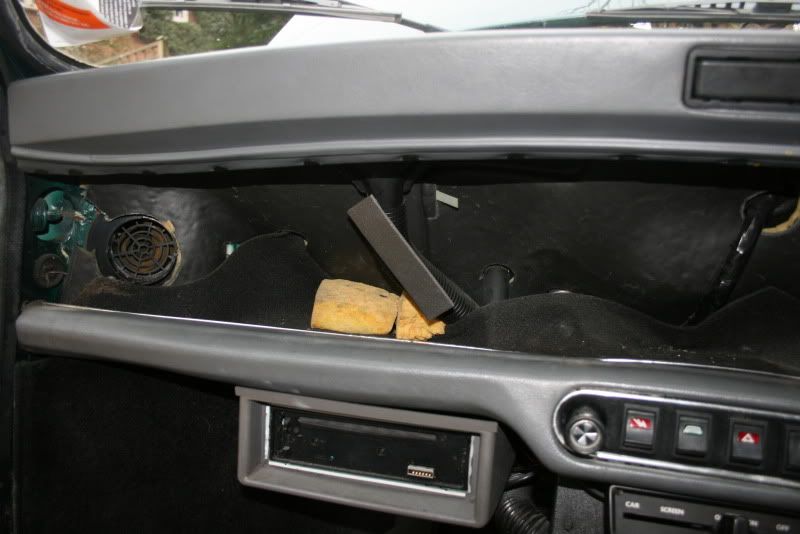

With some exploration i see where the wing nuts go.
The dash seems to be wider than the space provide (like quite a lot wider) should I just try and budge it in?
Also, shall I just take the wirse for the radio up one of the holes in the back?

You can attach yours, lift up the dash carpeted area and you should see where the brackets should bolt into
Not sure whats going on with them two center brackets on yours though?
