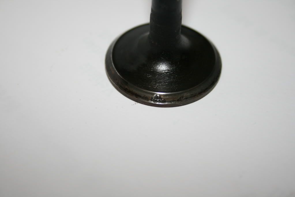

The head is a minisport stg 3 head that has don about 5000 miles I have striped it down for my re build and have noticed some pitting on the exhaust valve.
whats the cause of this and what should I do?
Here is a picture of my valve

Hi, is that the only valve and position that was pitted? if so, could be debris or i have known Minisport to have very bad quality parts in the past with micro pitting in new parts so could be erosion..

they are all pretty much the same as this but the inlets are ok.

What about the build of your engine, what CR and what fuel and oil have you been using? Is it unleaded head?

Are you using an additive/ lead substitute? Could be the valve micro-welding to the seat through lack of lead.

no it's an unleaded head atleast it's ment to be
IIRC it was running 9.5:1 CR (what ever a standard 1275 with 21.5cc head would run) and i was using normal 95 octain fuel. and I was using comma 20-50 oil and prior to that semi sinthetic 10-40
