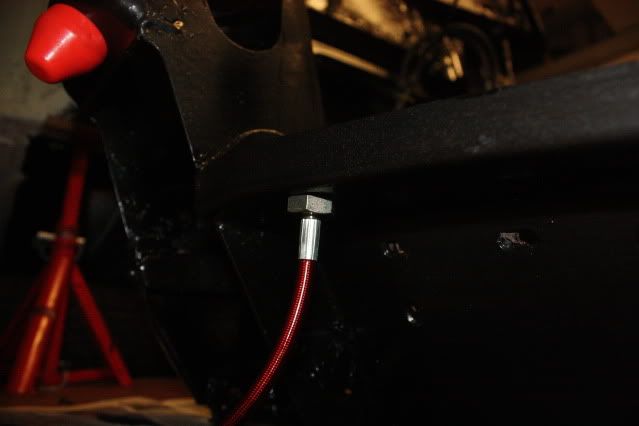

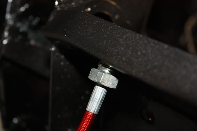

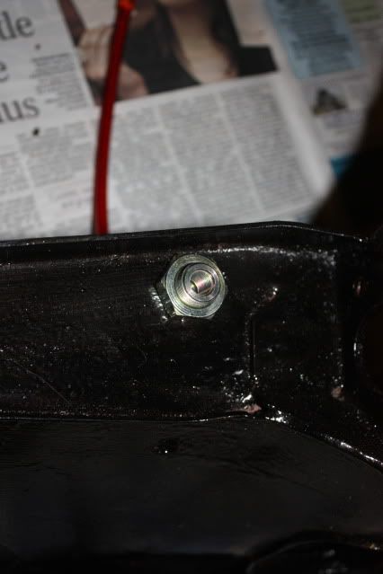

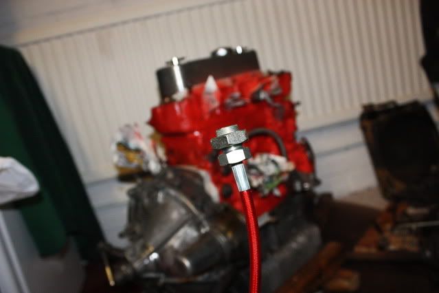

Just for you DMC ;)
TADAAAAAA
what i did was to peel back / cut off the rubber hose bit to expose more but area, then because i was also afraid of stripping it i hacksawed through the pipe so i could get a socket or ring-spanner on it, position it so if it spins it will lock into position.
Then get the correct sized socket and undo from above. I nearly stripped it too getting it off, before i realised it was undo from above.
