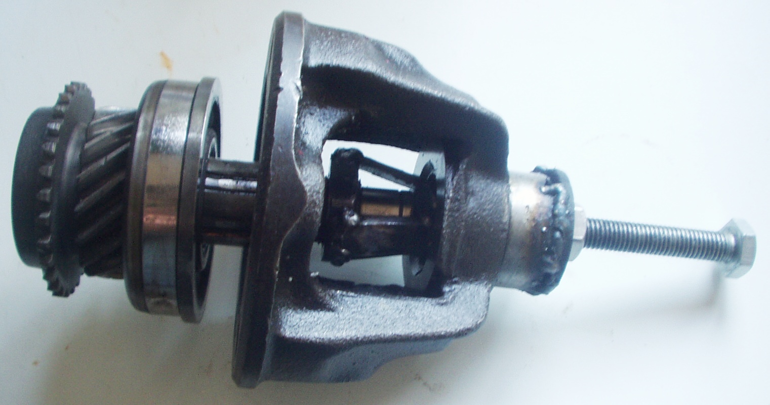

found a picture...
tool for removing first motion shaft of gearbox...

Only quick pictures but you get the idea.
Locks the primary gear to undo the first motion shaft nut with the engine in situ.
Outer race puller for the transfer casing idler bearing. Only half shown :(
