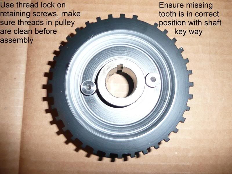

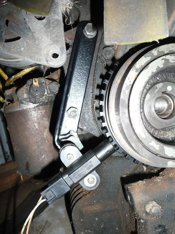

ta..da...

so that answers my question then you can fit the trigger wheel with the supercharger pulley
