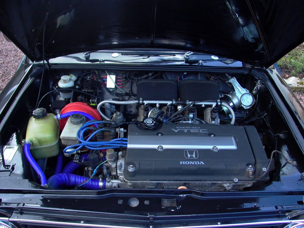

There is no brakes when it gets hot under the bonnet and the servo is very hot. Have changed the brake fluid but still. If I have the back of the bonnet up I never have a problem. So I see the problem as the heat under the bonnet not escaping. So I'm thinking the era vent will help and hopefully still look standardish but cant visualize it on a clubbie.
To give an idea of the space: Posted Image

It's probably due to the radiator positioning on the B16 and D16 conversion - it has to sit way over to the drivers side of the car - right in front of the servo, which was always designed to be about as far away from the rad as it can get it a Mini. Sorry I can't help with pictures but the VTEC install looks very neat & tidy!

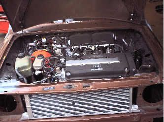

my rad is the whole of the front. Custom one in the grill space so most of the air comes through the rad. Just cold air comes from under the number plate vents.

Shouldn't think the expansion tank next to the servo and the coolant pipe draped across the fluid resovior is helping.
Have you considered re-positioning it or thinking about a radiator with a expansion bottle mounted on the side?
Nice engine instalation , very tidy looking.

Moving the expansion tank, where is there space, and going smaller would reduce the amount of water in the coolant system. So I think I just need more air flow in the engine area but want the minimuim cutting.
The rad: Posted Image

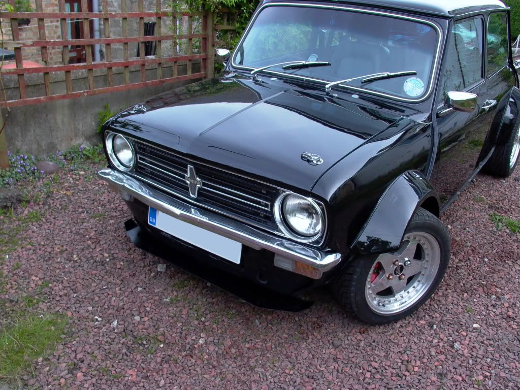

Not heard of this before but I see what your ob about. I love your rad design. I was looking at something like this but couldn't afford to get a custom one made and fit as I'm using a standard roundnose. You still have all original looking inner wings which will keep alot of the heat in. Try putting some more vents in there to aid getting as much air in the bay as poss. Could also try a small venturi style scoop at the front just under the valance that ducts air up into your bay more than normal. I'm thinking about something like this for getting more air to my rad as it's well up behind my drivers light.

Something like this on the front:
