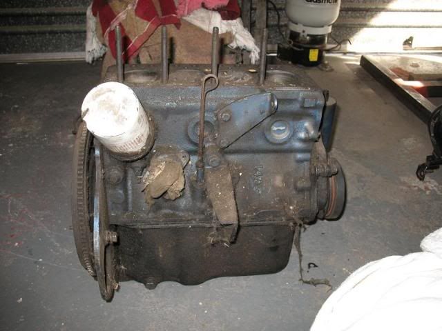

heres a picture of it
If I change the crankshaft I could use it for a rebuild, i think.

Your description of the oil filter made me think it was a Meastro engine but they were A+ units I believe and having seen the photo this is an A series . There are various minor problems with using the block but I think they can be resolved. I believe Guessworks has built Meastro engines onto Mini gearboxes. You need to use a short oil filter or it hits the bonnet I seem to remember. You're right that you can't use the crank though.
#7 Guess-Works.com
Guess-Works.com
    Gearbox Guru
  • 19,838 posts
Posted 27 March 2010 - 07:28 AM
Maestro engines are easy ( infact there are no 'real' modifications necessary ) and make for very strong blocks..
However, I believe the inline ( midget, marina etc ) engines do need a modification to the flywheel end main cap. it may also be worth checking the diameter of the oil feed hole from the sump as this will be threaded, the maestro block is ok, but this may have a larger hole which the O ring will not seal on to.

It'll be a threaded bore in the block that the pickup pipe screws into, as Guessworks says the important point is that the flat outer area around the thread must be of a decent size for the O ring in the Mini gearbox to seal against and it must be in exactly the right place.

You guys keep mentioning Marina engines. Your Marina's had A-series engines? Ours (U.S.) all came with B-series engines.
So... what DID the engine in the picture above come from? I had heard of the Maestro engines before but as soon as I saw the picture above and noticed the alternator bracket type I figured this had to be an A-series not A+.

There were 1.3 Marinas fitted with A-series and 1.8 Marinas with the B-series.

Someone told me it came from a morris ital after checking the engine number.
