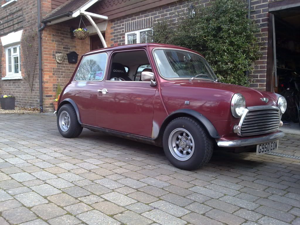

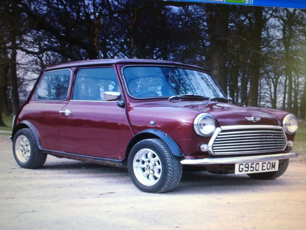

Right, Thought id post a thread about my MOE as ive had him for a year and its time for his MOT.
I bought him from a guy in kingston about a year ago. The previous owner was his cousin who had owned Moe since new!

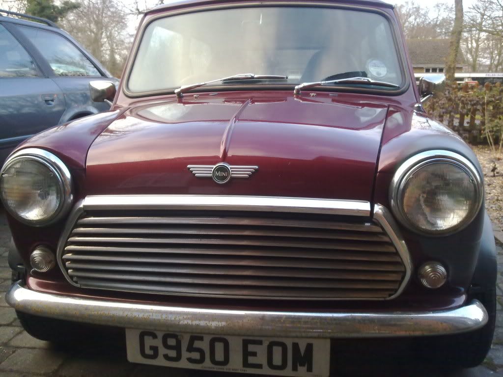

When i bought him he looked somewhat like this.
After a year

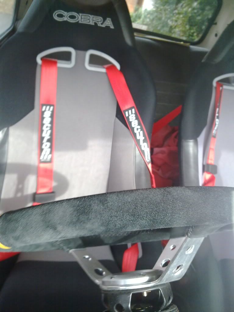

Cobra clubman bucket seats
Quick shift by minisport ( this broke recently so have got something a bit more special) pictures to come when it arrives :lol:
6x10 gb alloys
i originally upgraded the 8.4" discs to grooved and drilled with ebc greenstuff pads but needed 7.5" to put my 10's on!
mk2 rear lights
rear seat taken out
Harnesses

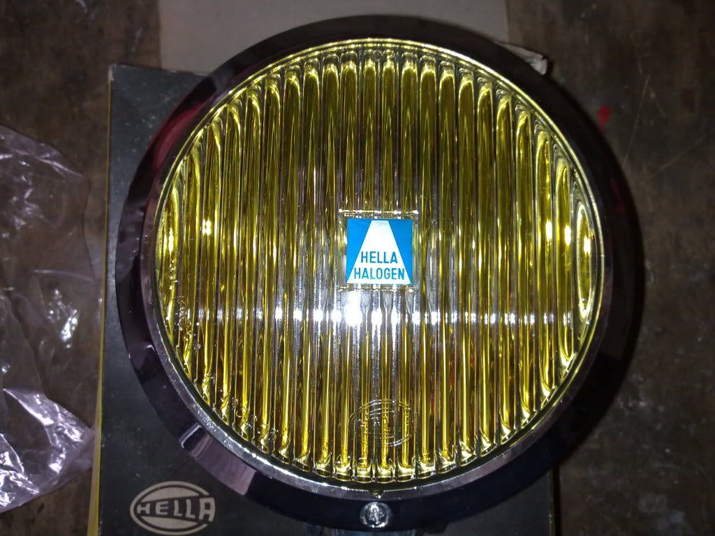

How about this for a reverse lamp? Dunno bout the colour it has to be though? :D
Any opinions?

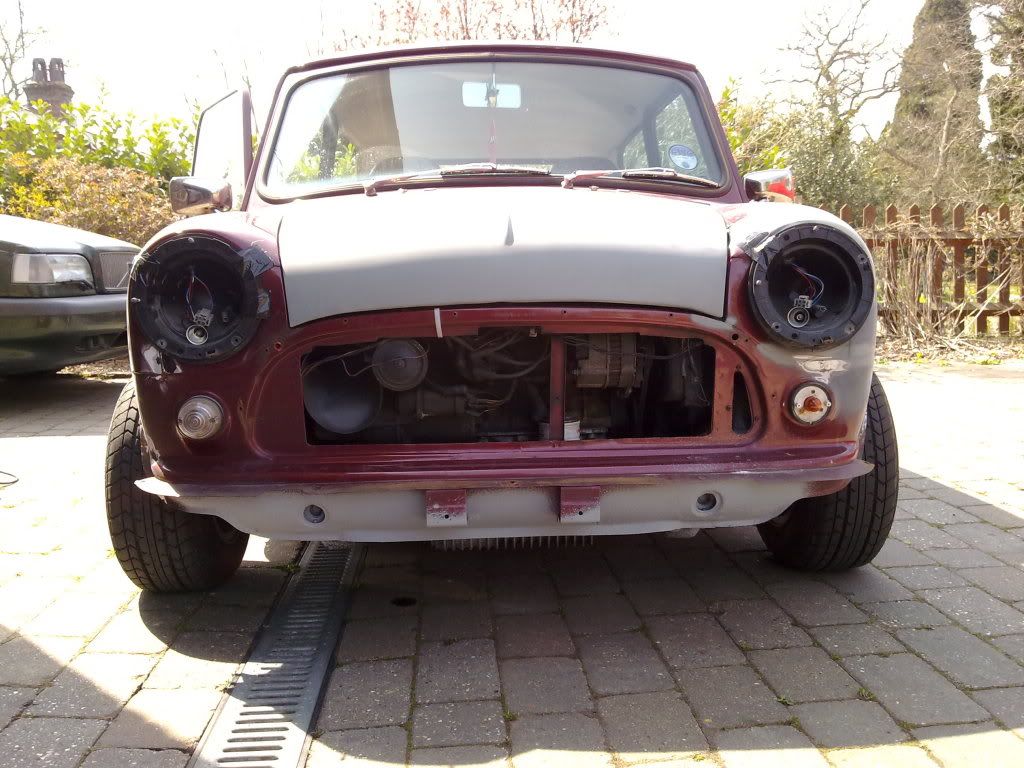

Exciting times are afoot!!
Firstly i have convinced my workshop controller to let me sneak in some time with the spray booth next weekend. I asked the other apprentice if he would like to help me spray my car and he was kind enough to say " well........ok" lol

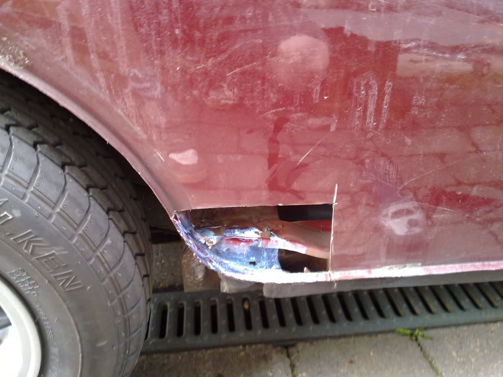

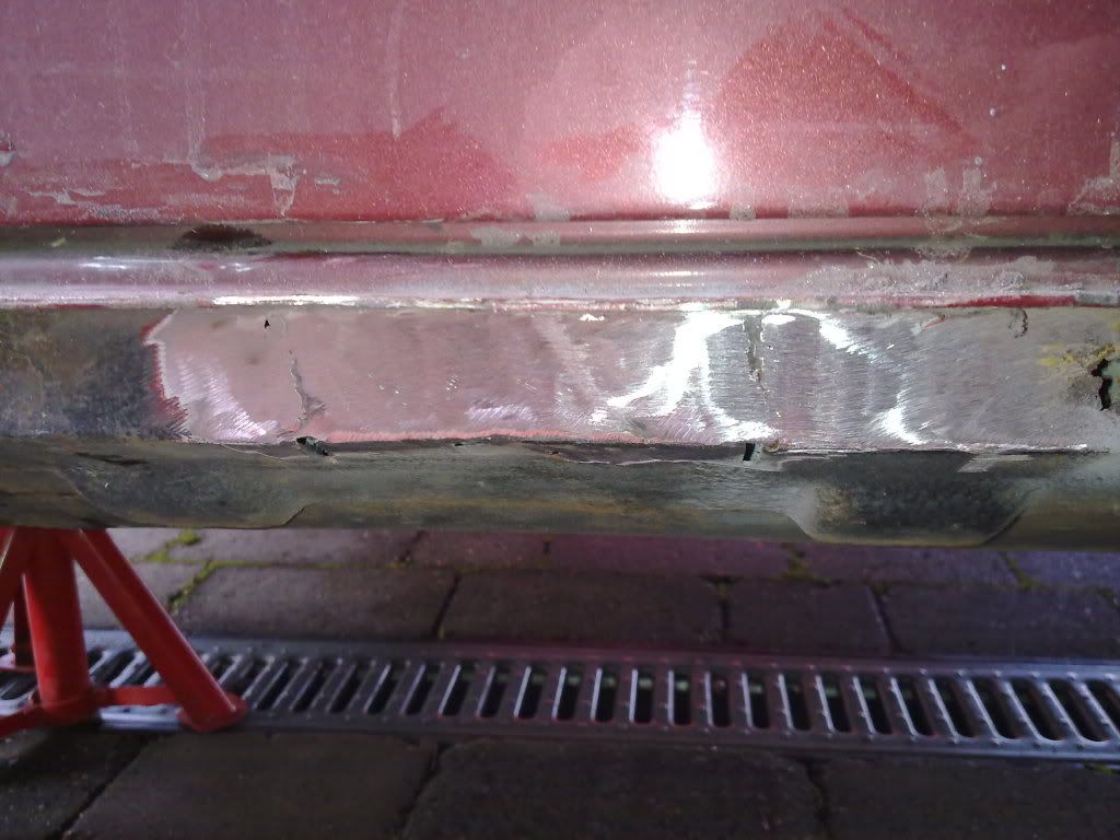

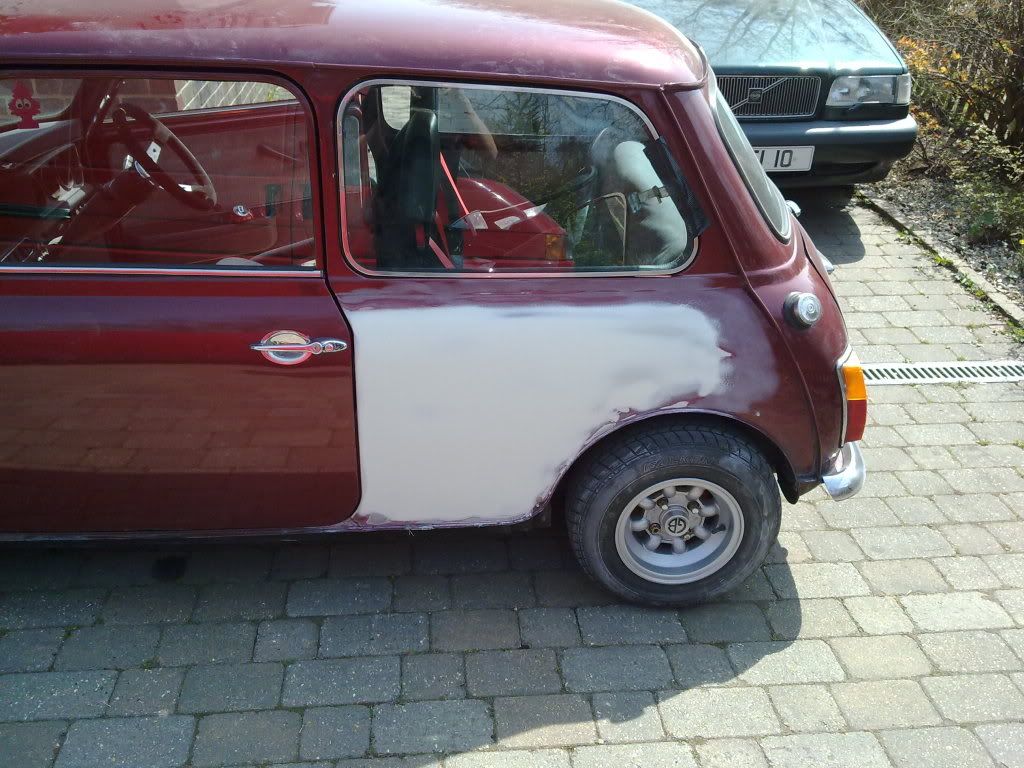

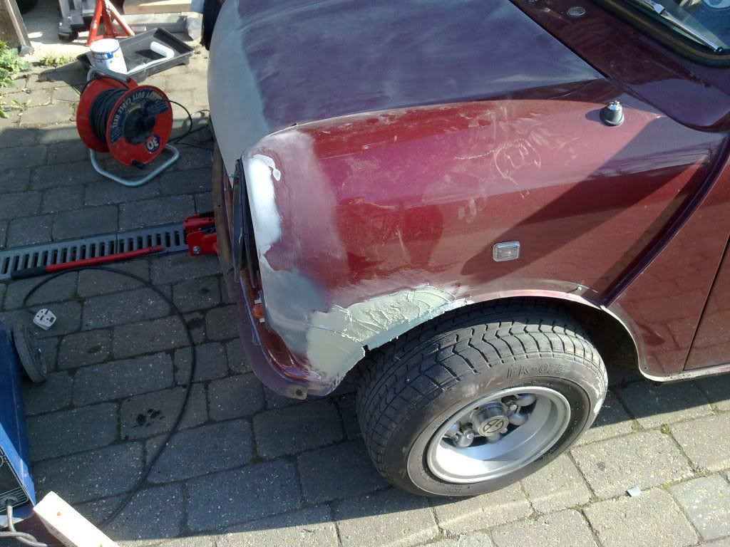

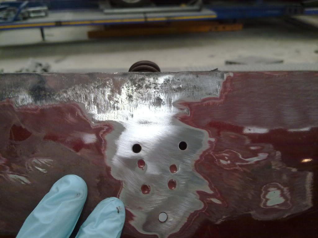

So, This weekend was spent getting the bodywork straight. Which i thought........easy enough. few ripples and dents and were sorted....................NOOOO!!

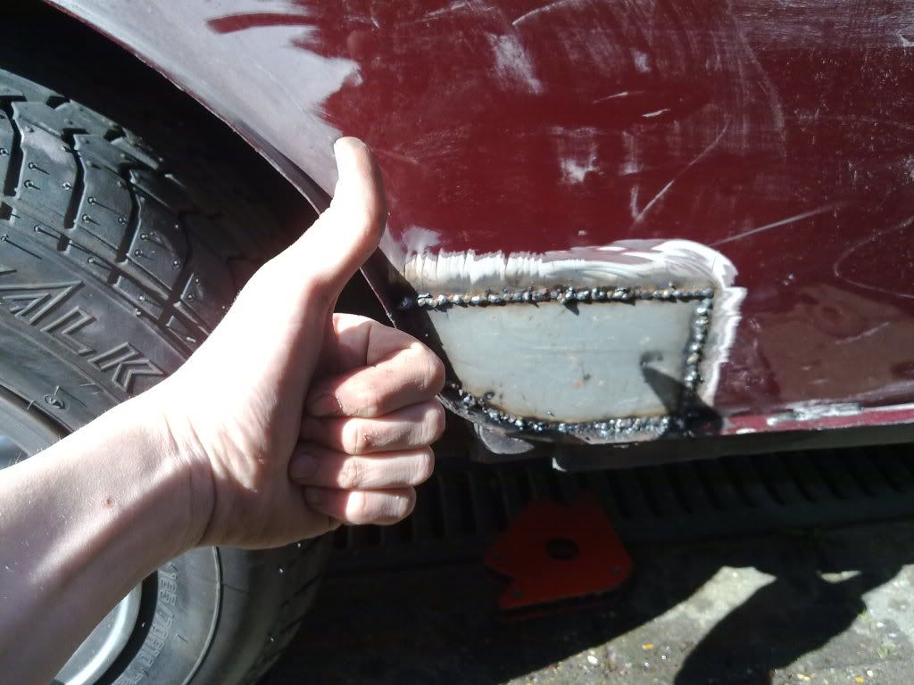

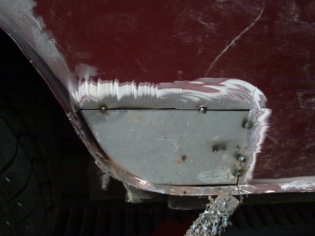

There was rust hiding everywhere!! front panel,arches,1/4 panel, os door! . So i fixed both 1/4 panels saturday morning and got my car back home (with no lights and no arches with the 6x10s sticking out wayyyyy illegally! lol naughty boy :) Then got the front arches welded, 1/4 panel welded and some other bits in filler.

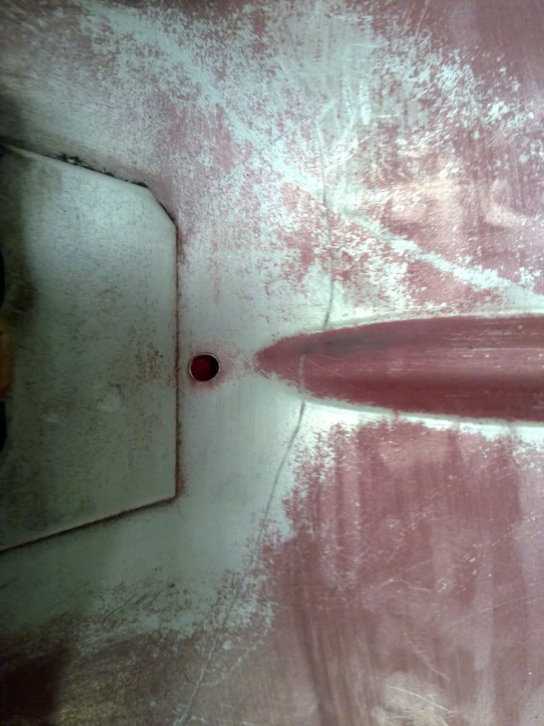

Sunday (today) was spent on the door. Snapped two studs getting it off. Even though i had the thing off a month ago! grrr. ground back some rust and applied kurust, filler,etch primer the high build.

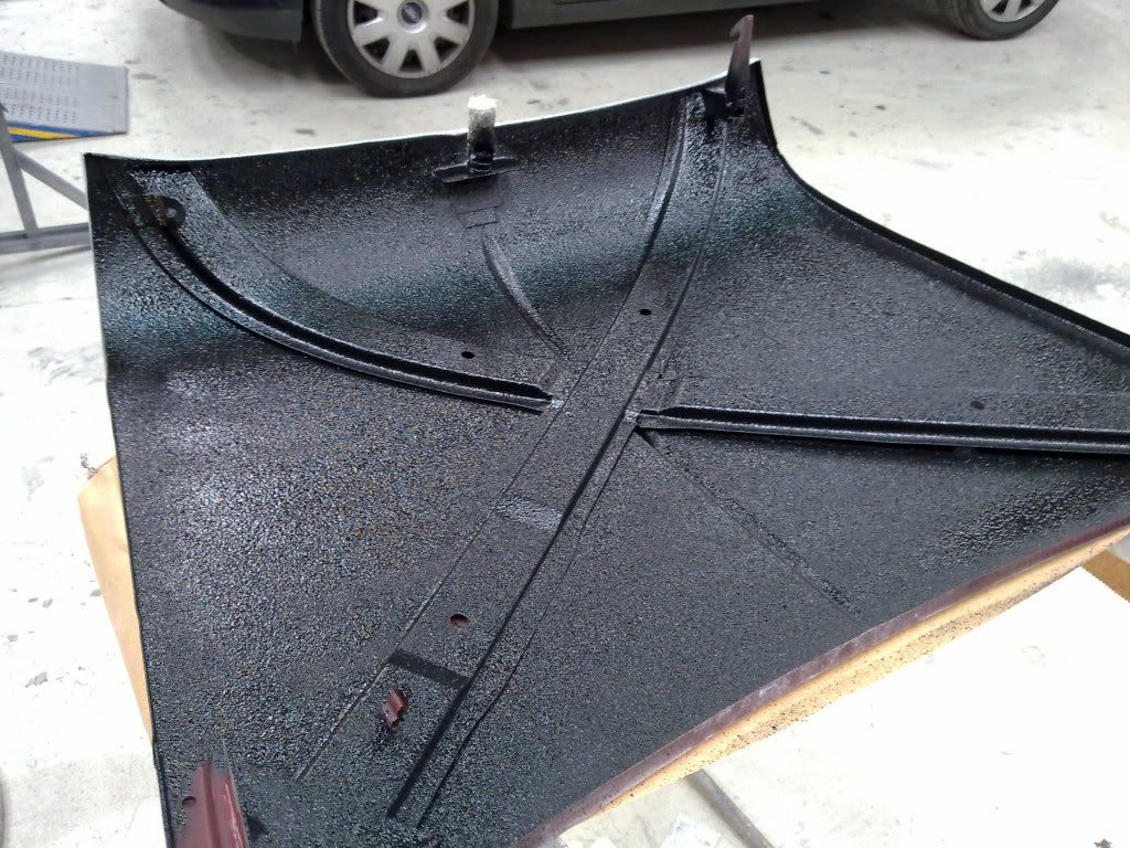

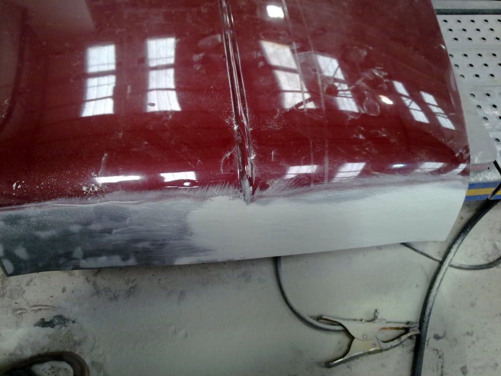

bonnet

Quarter panel rust removal

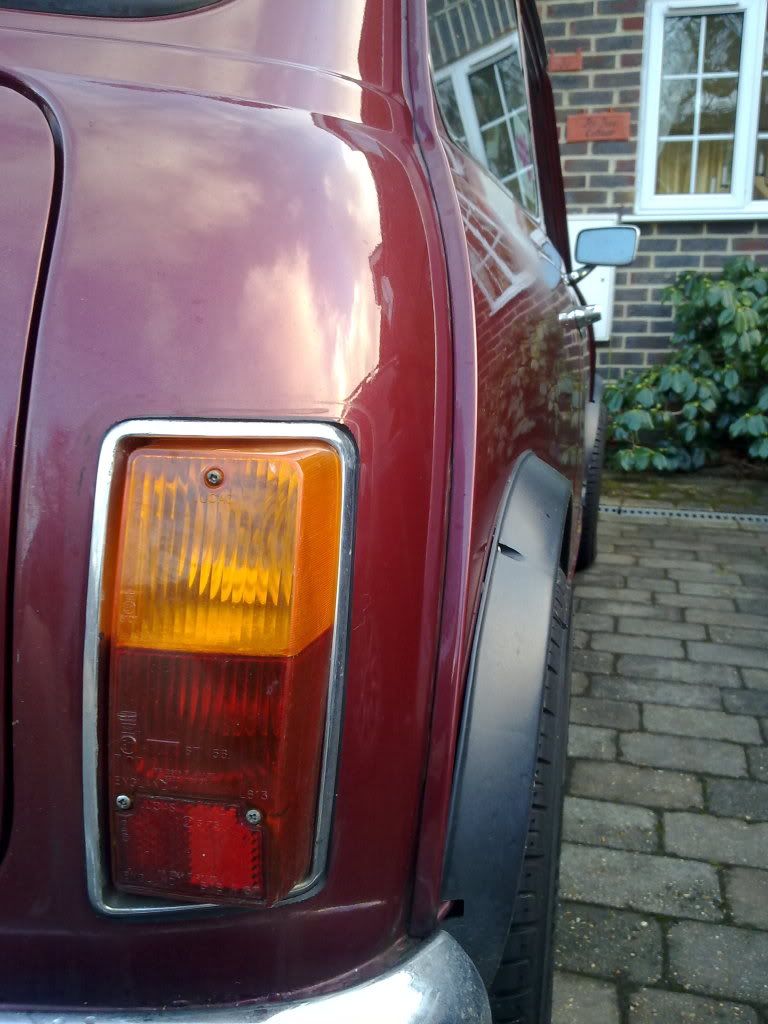

I have been watching this one!!

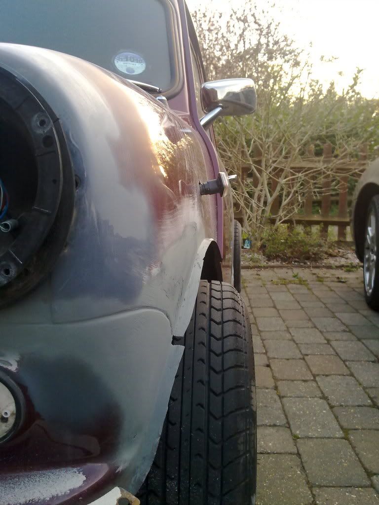

Have you got any pictures of it front/side on without the arches? Just so I can see how much the wheels poke out!!

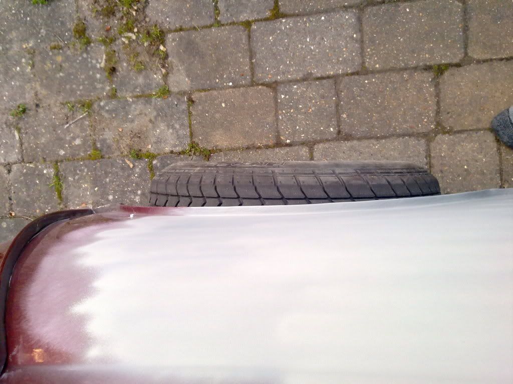

I can get one lol tis wayyyy too illegal!

Spose id better update?! Paint has been ordered, picking that up tomoz. came home and jumped straight back in to rubbing down filler. got the two wings in final skim just waiting to rub down. 1/4 pnel needs a final skim and door needs to come off to repair the studs and the edge between a panel. a panel will be done tomoz!!

Some pictures of tyres.

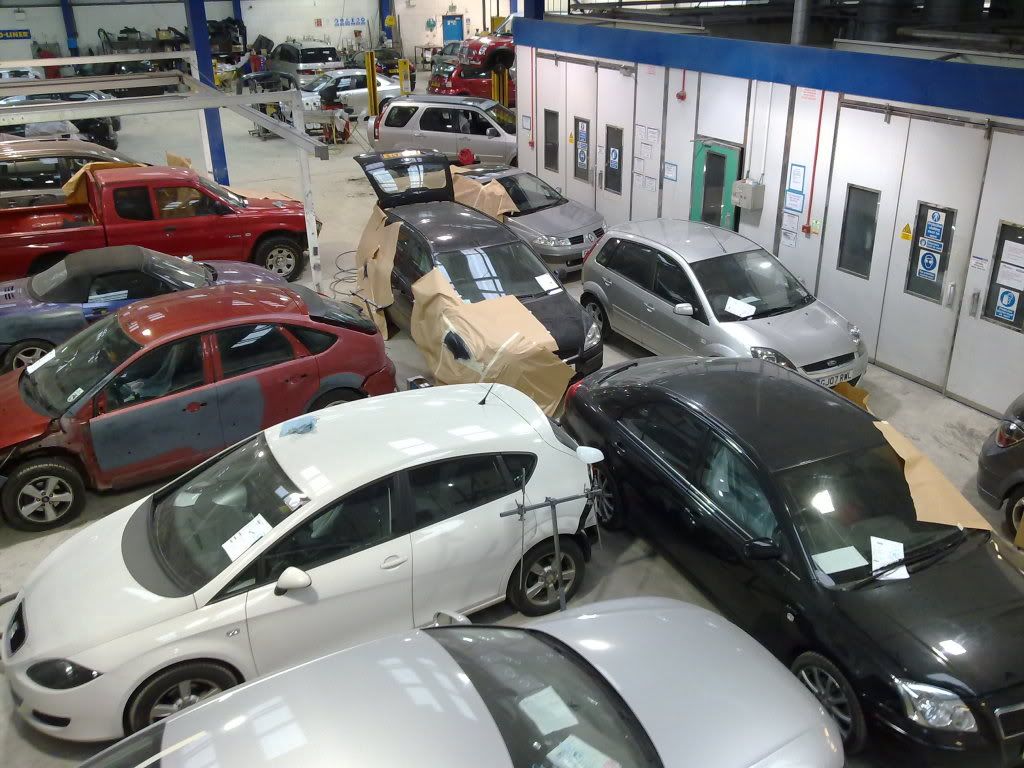

This might make you laugh....this is how busy we are at work ;D

They stick out like sore thumbs huh? ;D
thanks for getting them for me, appreciate it
Edited by GreaseMonkey, 26 April 2010 - 06:29 PM.
