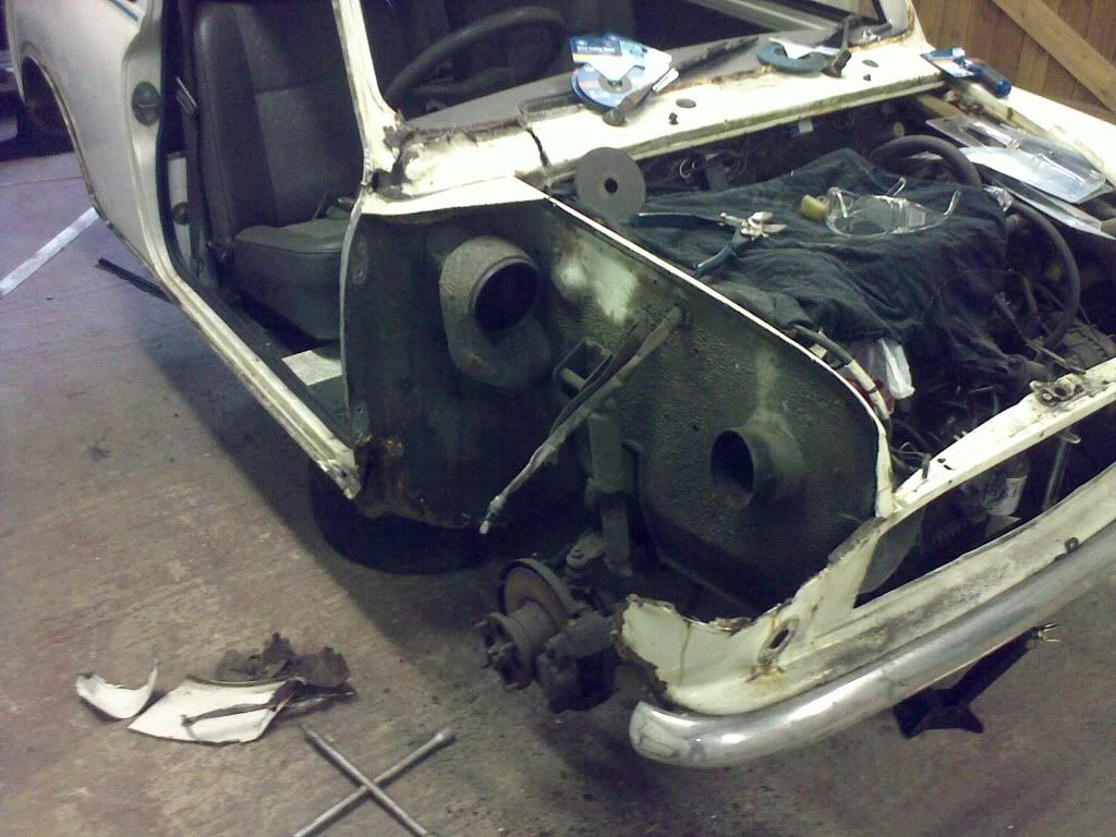

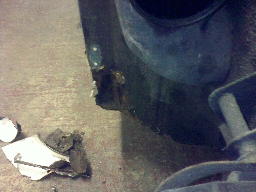

Eda basically needs a new front end. So I had to have my first go at removing panels, something ive been daunting for some time, I also am very limited on toolage due to a complete lack of funds. anyway as with all minis, the more I cut the more i found that needs removing. Heres where ive got upto today
All this to replace the scuttle

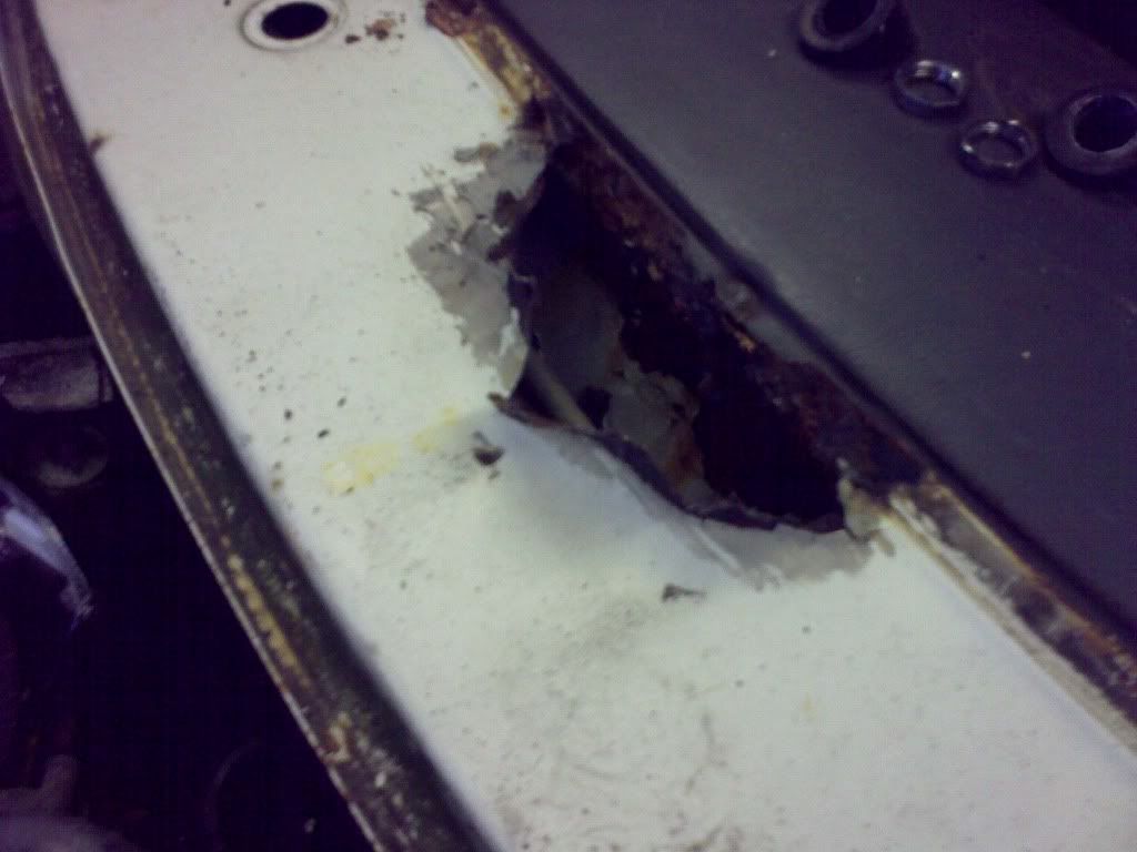

First job was to remove the a panel, the foldy round bit had be confused for a bit as i couldnt see the spot welds. This also revealed a loverly hole in the flitch panel, so will need to make up something to repair that with (cardboard and fibreglass ok? just kidding)
The hole.....

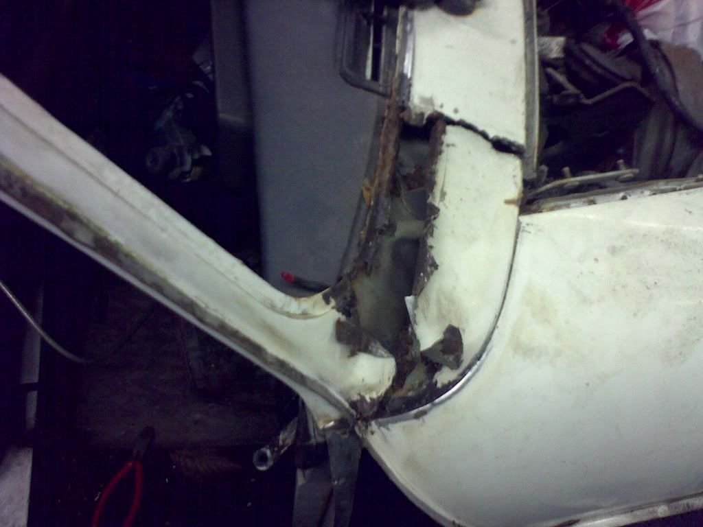

Then i plucked up the courage, fired up the grinder and did this....
Boy was that scary ;D

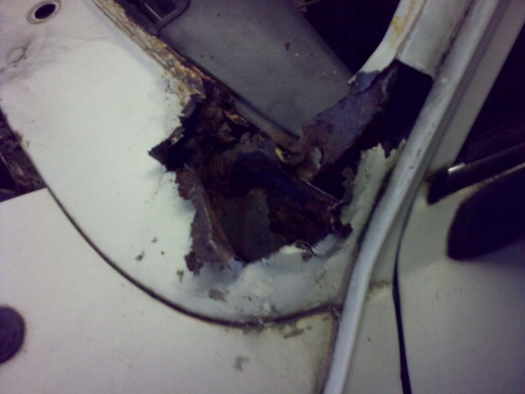

The other side isnt too pretty on the scuttle either, anyone know what the panel is called that the scuttle welds too - because thats gone as well.
Must hide any tool capale of poking...

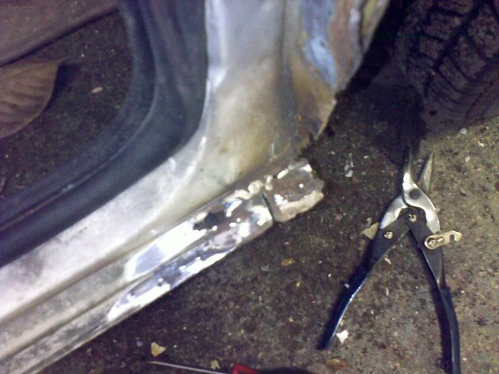

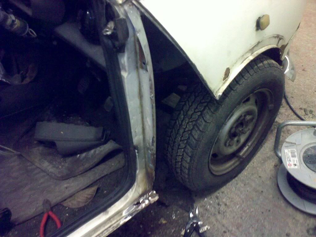

A hole near the OS A Panel/ Door step, on the bit where the sill welds too - not sure what im going to do here yet...
Managed to get the scuttle closing plate off as well but forgot to photograph that. Still not bad for 2 hours work :P (at least by my standard)
Comments always appreciated.

EDIT : There was a creative use of filler mind on that scuttle, for all intents and purposes the filler was rock solid and passed the poke test - but not the wire wheel test. How the flitch panel was missed though is a bit beyond me. Also quite a large hole in the sills which I shall get too.
Picked up some new sills from Malvern show and had a bit of a blonde moment, ended up with two R/H sills ;D

i know how you feel cutting into the body work, ive done the same thing this weekend to fit a fibreglass front end
when i did my rebuild i had to replace the top 6'' or so of the bulkhead (the part the scuttle welds to)
for what you need to replace i would make a patch, i dont think you can buy a replacement without buying the whole panel (which was about £350)

Yes well im practising on this one before I have to do it my Mary lol, still hurts though. I was amazed at how smokey it was, quite a few times I thought it had caught fire as smoke came from under the wings, have a picture of the rust that fell off too - thats shocking to see how much 'structure' is literally hanging on by a thread.

The scuttle is welded to the bulkhead and top dash rail to make a three layer "sandwich". I have a heritage top dash rail if you need it.
Thanks, I think its the bulkhead bit thats 'missing' - how much for the dash rail, I know at least one of the other minis needs one.
