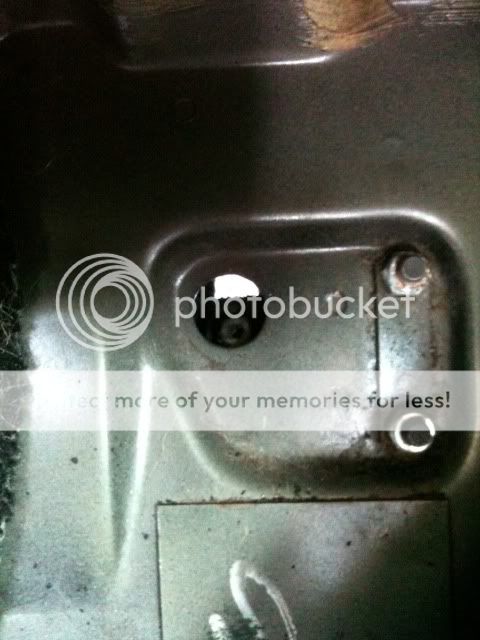

my steering rack always seem to start to work itself loose, i have checked eveything and all seems ok and in good condition
but i checked again today and it seems to of moved...again and my steering wheel isnt straight now when the wheels are
i popped the grommet off the other side and this is what it looked like, surely that should be in the middle of the hole?

From what I can see in your picture, it would appear that the plastic bung in the rack (used to cover the centering hole) is sitting about right. Therefore the problem is probably down to the column/ pinion splines. Check that nut and bolt straight away, it's super-critical from a safety point of view, if this fails completely an accident is waiting to happen :)
