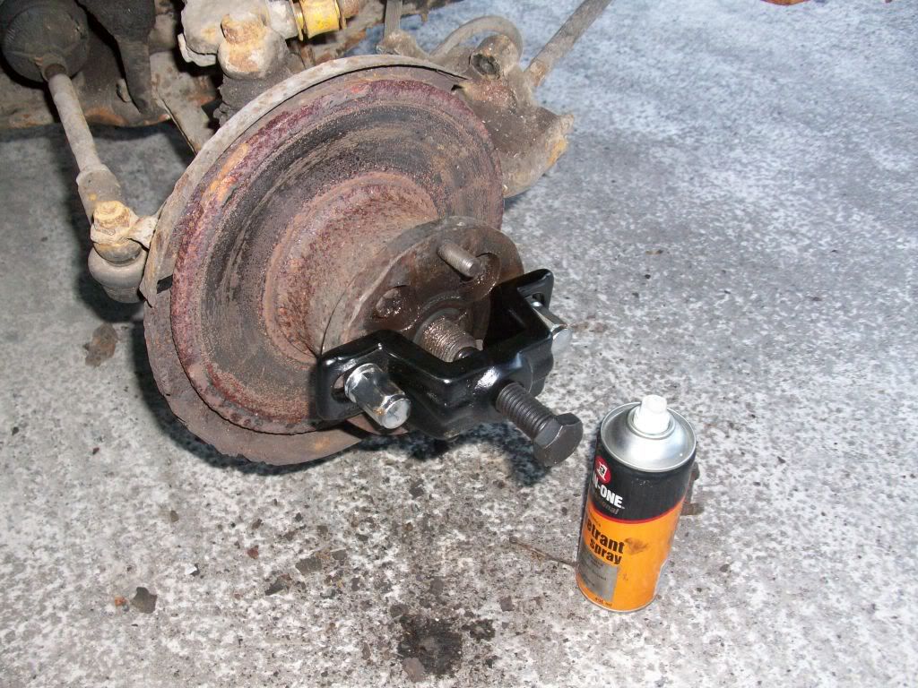

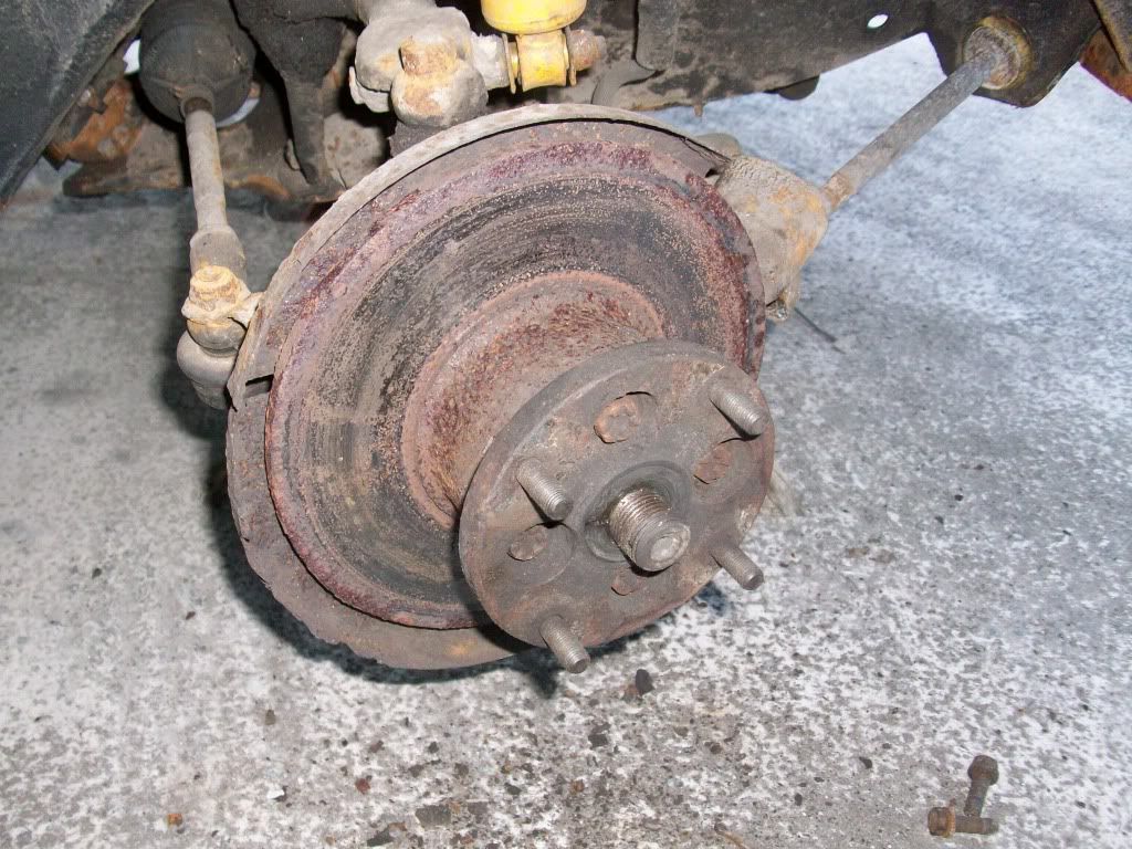

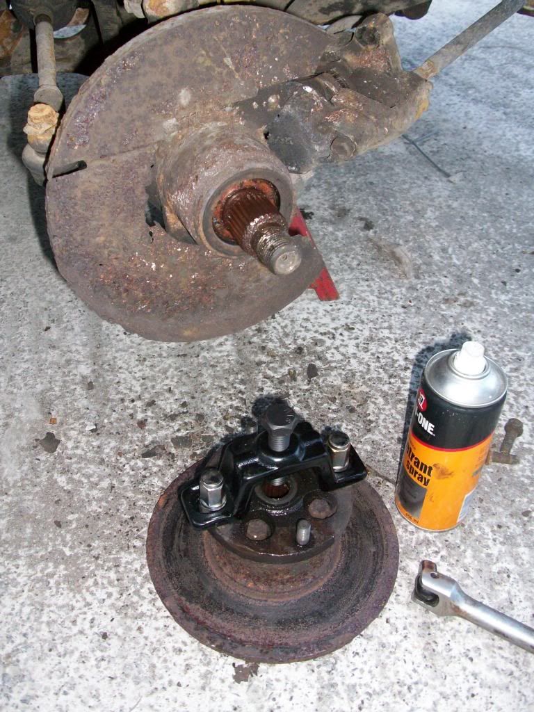

#14 mymini007
mymini007
  • 2,046 posts
Posted 22 April 2010 - 08:31 PM
Well we have a result.
The stuck disc
The puller!
The result !
#15 asmith88
asmith88
  • 861 posts
Posted 22 April 2010 - 08:58 PM
Nice one, glad its off, but how longs it been on there for, a billion years! ah well, nice new shiney ones on now at least!
