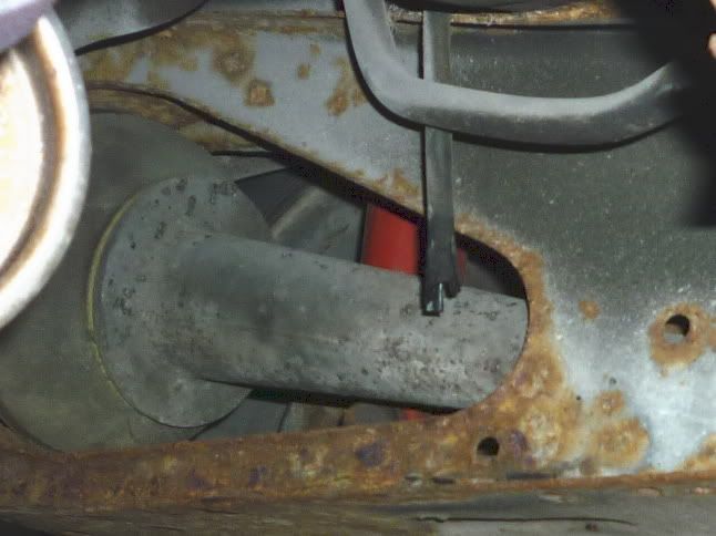

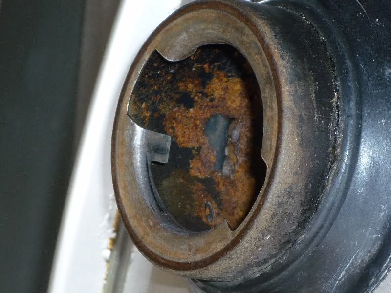

i think i may have found my problem see pix, next question is does a new tank come with a sender or do i need one of them too.
. hole in filler neck of tank and frayed end of breather pipe, think i might have rubber pipes renewed at same time

i am assuming the filler neck is part of the tank and not like modern cars a liking pipe ?
#10
Posted 06 June 2010 - 09:32 AM
Yeah the filler neck is part of the tank. Get a s/h tank from somewhere. Shouldn't take more than about an hour to fit.
