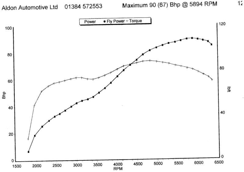

Posted 04 June 2010 - 09:04 AM
Ooh, just found the RR graph for the 1310 I had:
The spec went something like:
HIF44
Standard stage 1 stuff, 1.75" exhaust
'Stage 5' inlet and outlets (37mm/31mm)
Cooper s double valve springs
1.5:1 roller rockers
Power max pistons
Lightened con rods
Lightened / balanced crank-flywheel-clutch
Kent 276 cam

#9 Pauly
Pauly
  • 4,213 posts
  • Location: Wolverhampton
Posted 04 June 2010 - 07:11 PM
So about 80-90 fly power, about what im thinking.
Cheers guys :lol:.
