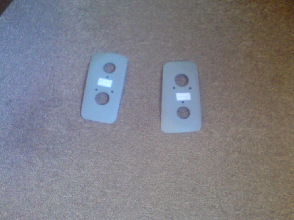

hey has anone found a pair of conversion plates that actually fit, i got a pair from somerford minis one side was bigger then the other, so i went on ebay and got another pair from another company, they look to small and dont cover the hole.... what shall i do, im starting to give up on this idea.

i try and find the light panels that have been cut from a mk1 shell, they turn up from time to time, and usually try and get them with as much extra panel work as you can, i got some for £12 and the panel goes right up to the boot lid opening, so will make fitting a whole lot easier! n much cheaper than buying the conversion plates!!!
