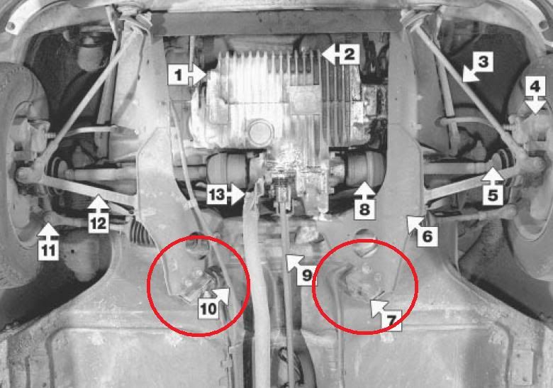

dont want to hijack your thread but has anyone got a similar photo showing all the mounts on the rear subframe with nice red circles around them....thanks, :proud:

94Mayfair the rear subframe only bolts on in 4 places.
Its basically a square frame, the mounts are in each corner..2 bolts per corner hold the mounts on.
We've used orange polybushes on this one, but shows were they are :proud: will be black rubber if original
Ignore the orange mount in the middle thats exhaust mount
Edited by lrostoke, 10 June 2010 - 07:45 AM.

thanks for the info/piccy, :(
