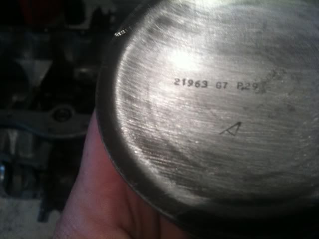

Im pretty sure thats been rebuild before as the pistons in an Mg engine are these.
These were in both of my mg engines when i stripped them.
