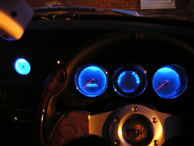

From looking at the picture of the clocks above, it looks like it'll take about six but not sure if it changed when they brought out the newer clocks.
