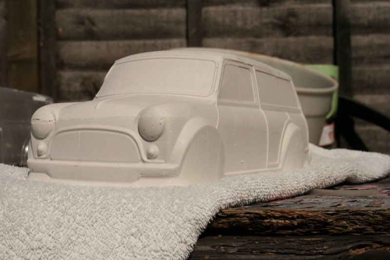

well the abc countryman shell arrived this morning, so a trip to hobby craft to pick up 4kgs of plaster of paris was on the cards, with all the vitals collected, heres the progress i made today, i just have to let the plaster full harden before i attempt to remodel it into a clubman estate shell....
so far so good! should be mocking the chassis up for it soon, im going to build my own rc car, will be a good trial to see how it fits/what will need modifying in the moulding process to make it easier etc

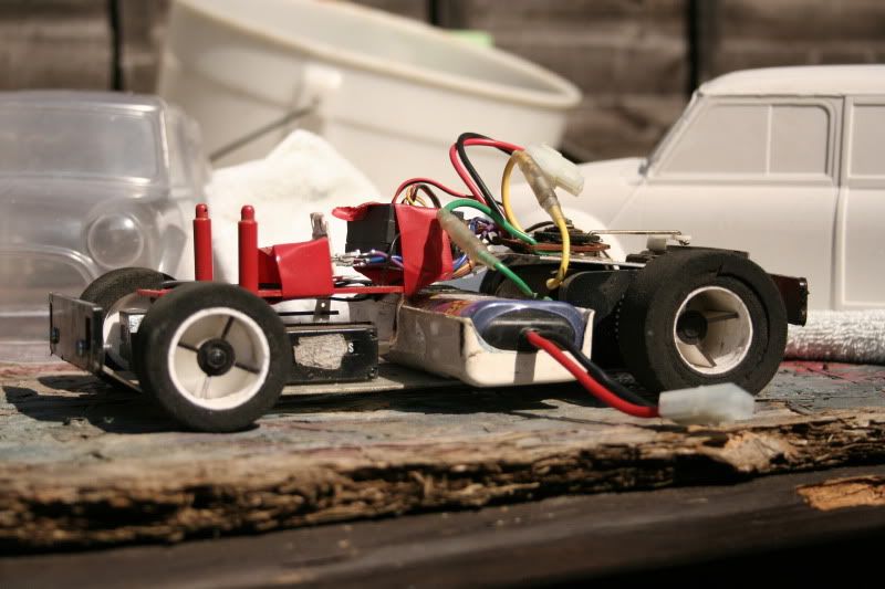

Few teaser pics:
They seem to show up allllllll the imperfections but it's pretty sound in the flesh.
