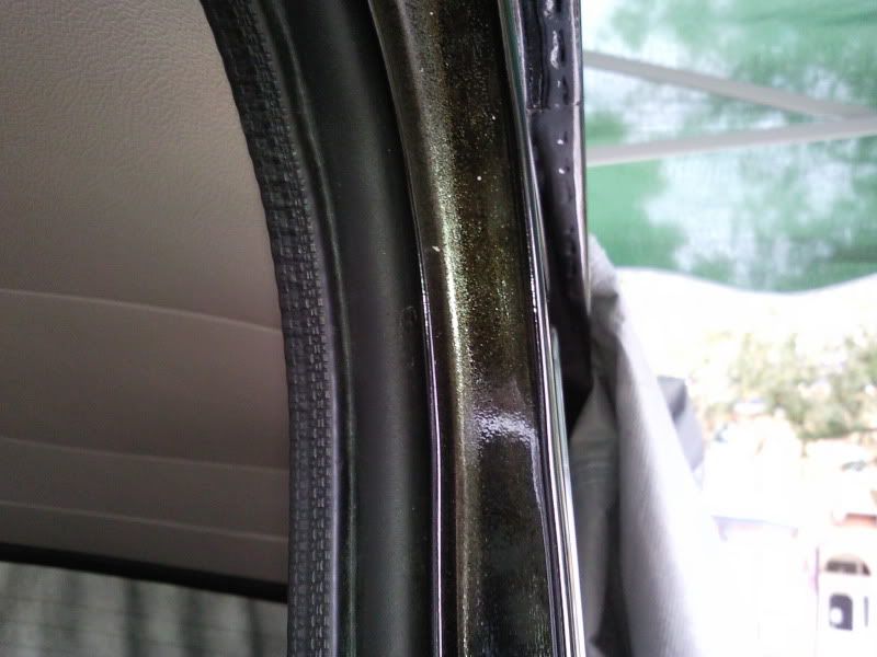

Its hard really to show on photos but here goes. Here you can see the window frame at the rear corner is just about sealing against the seal:
All the way round the back edge of the door and along the bottom of the door its all the same as above, seals properly against the seal (seal is off on this photo):

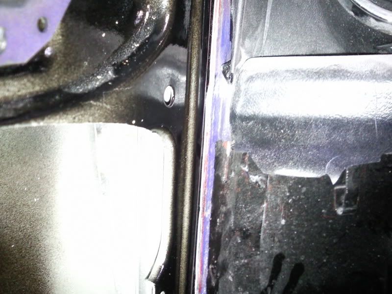

Now its hard to tell from the photo but higher up on the inner front edge of the door (just below where your door release handle would go) the door comes very close to the lip for the seal. Here the seal is removed and you can see the gap is only a few millimetres, so with the door shut and latched like above the seal is well and truly crushed!
So me and my dad are pretty much stumped with how to sort this.

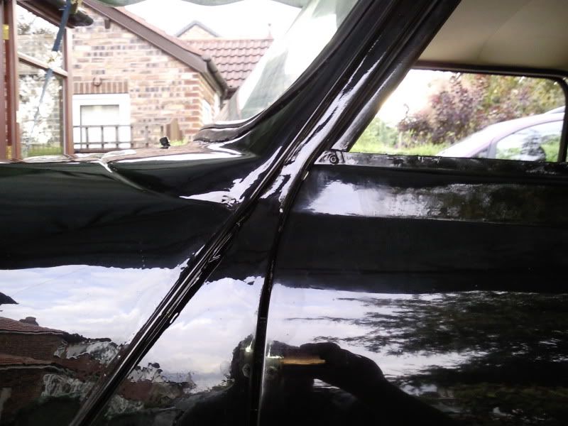

The only idea we've come up with is to remove the door and file the hinge holes in the flinch panel slightly wider towards the A panel, to allow the front of the door to be positioned a few mill' further away from the seal. However I think this will cause clearance problems with the A panel when the door is opened. So then my dad suggested to try shimming the door backwards to compensate for that, which needs doing anyway as the upper hinge region gets extremely close to the body:
But the back of the door barely has any room to be shimmed backwards anyway because where the door skin is folded round the frame theres only a few mill' to work with:
So really whatever we try were stuck...
Any thoughts on our idea to file the hinge stud holes wider to move the front of the door out? Because i've noticed looking at the door that its only lower down on the A panel where the door moves inwards as its opened, so maybe just filing the top hinge holes out, we'd get away with the clearance...

I had to tweak the seam that the seal fits on on mine last time (although I had to move the seal closer to the door on the upper part of the front. You should be able to bend the seam in towards the centre of the car a bit without too much trouble. Be careful if you elongate the holes that the door doesn't catch on the A-panel,

Yeah I thought about doing that also, just looked like pretty thick steel and that even with it bent, the base of the lip would still be really close.
It'd be the easiest fix really, I might try it tomorrow.
I'll just use some mole grips or something to bend the seal lip further in and see how it goes...

Other than that, you say there is no way to budge your door backwards but looking at the last photo in your post, it appears to me that the door is sitting too high as the swage line in the door skin doesn't line up with that of the rear quater.
Have you tried opening the door, holding the bottom of it and pushing on the top of the frame? Mini doors were never a perfect fit, they got beaten, twisted and all sorts to get them to fit each individual shell. Just don't go mental!

I know what you mean about the swage line it needs a shim adding to the top hinge ideally, but the gap is equal along the whole back edge of the door so don't want to spoil that. Also with the fold of the skin being quite thick, I think it'd catch if I shimmed it backwards.
I think i'll try and reshape the lip that the seal sits on, then if that works ok I can concentrate of adjusting the door without it catching and getting it lined up properly.
