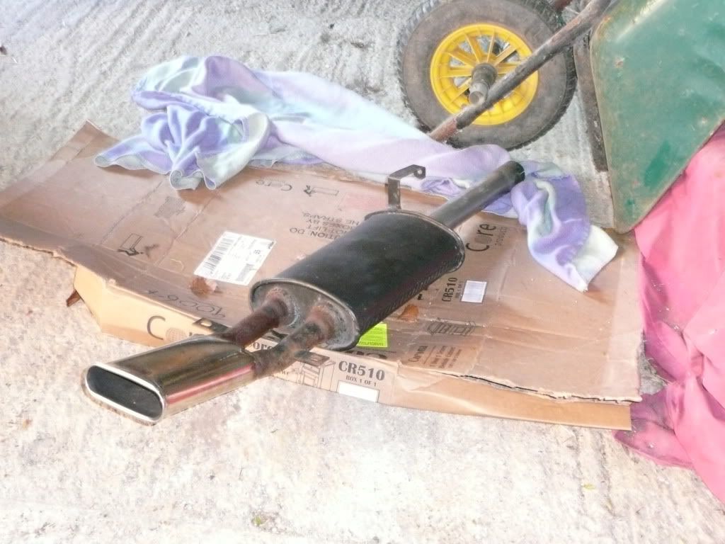

Sorry to hijack also, but I recently made a compulse buy for one of these:
and it just looks very loud!! Haven't even fitted it yet!! But i was wondering if fitting an extra silencer is possible to reduce noise? But would that significantly damage the already stunted performance of my little mini?
You will lose a few bhp with that final exit for the reasons given above. To optimise power the final exit pipe MUST be the same cross-sectional area as the main exhaust pipe in order to keep the flow of exhaust gas molecules as constant as possible and at the right velocity.
