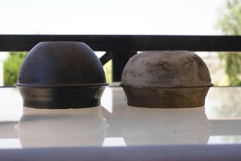

I've just fitted hi-lo's to mine, changed rear cones, but left fronts, they were fine.
#8 Barman
Barman
  • 1,068 posts
Posted 31 August 2010 - 01:36 PM
surely you'd fit new rubber cones and knuckles at the same time?
Depends on budget if the ride was OK and the cones not falling bits then why go to the £80 (pair) expense of replacing !!
I thought mine looked fine but the difference in the old and new was amazing!
Not as much as the old and new on the front tho!

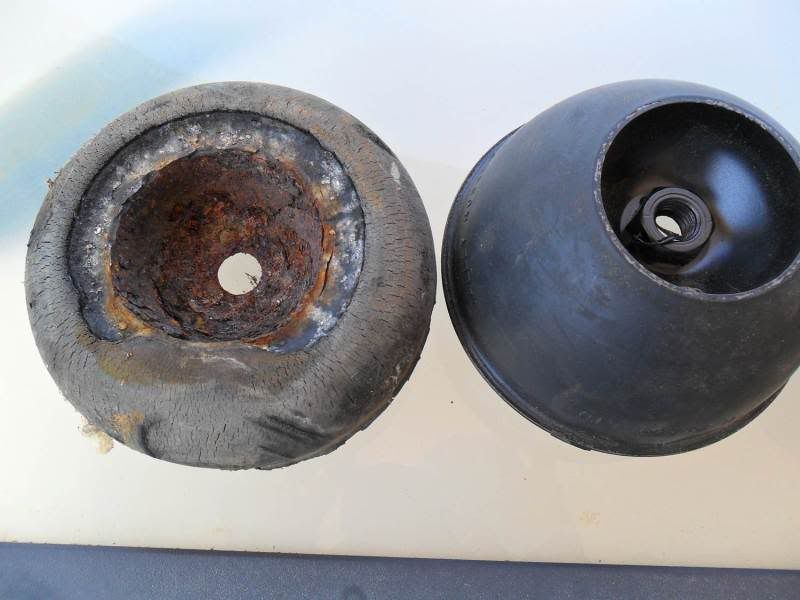

Yeah ideally I would have liked to of kept and used the rubber doughnuts just because of budget. However after 3 hours or prying I have managed to get it off. What had happened is the rubber had melted and indeed attatched itself to the metal and cooled into place ...so as we took it off the rubber ripped =/.
For anyone thinking of doing this in the future I would seriously reccomend just saving up and buying new ones.
I will be purchasing new doughnuts tomorrow as its just not worth the hassle and fustration.

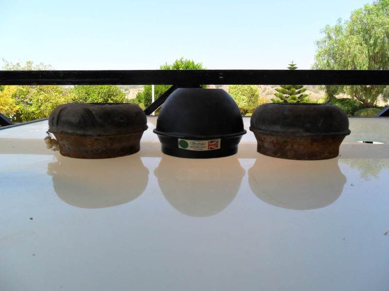

Yeh im glad your buying new ones.
I had this problem the other week, definatly worth the extra money.
With the new cones your suspension will sit really high, but as they settle down, you can adjust the hi los accordingly
