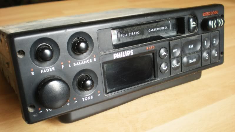

Hey, I have an original radio cassette player out of a Mini 30 LE, but I have lost the code. Is there any way of finding it out or bypassing it?
It's this radio
Cheers in advance, Pete

Places that fit radios might be able to bypass it. They have on mine before. The code hasn't been writen on the bottom of it has it, I've seen that before aswell. Sometimes the manufacturer can tell you from all the serial numbers and stuff but it's pretty old so maybe not

have you tryed the Factory code? Leyland used if i remember rightly from the radio books ive seen for em
most start life as 0000 Or 1234
also radio's ive took to bits have a small battery inside them that stores the code remove that and you remove the code

If you cant find a battery inside, then the memory chip voltage is held with a large electrolytic capacitor. look for where the power supply enters the radio and somewhere near should be the capacitor (probably the largest one on the board). just short it out to kill the stored energy and then if the code is still needed try the "factory set" as stated before. ie, 0000 or 1234.
I wouldnt worry about killing the radio, because its practically dead already :)

There a websites that give you the code to pretty much any kind of radio for about £3. I got the code for mine from one. Google is your friend :)
