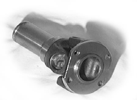

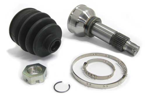

I took some things apart this evening and discovered something confusing. I have "hardy spicer" type axles with universal joints
I am really confused how this:
fits onto that...
![=]](https://www.theminiforum.co.uk/forums/public/style_emoticons/default/ermm.gif)
Help anyone?
