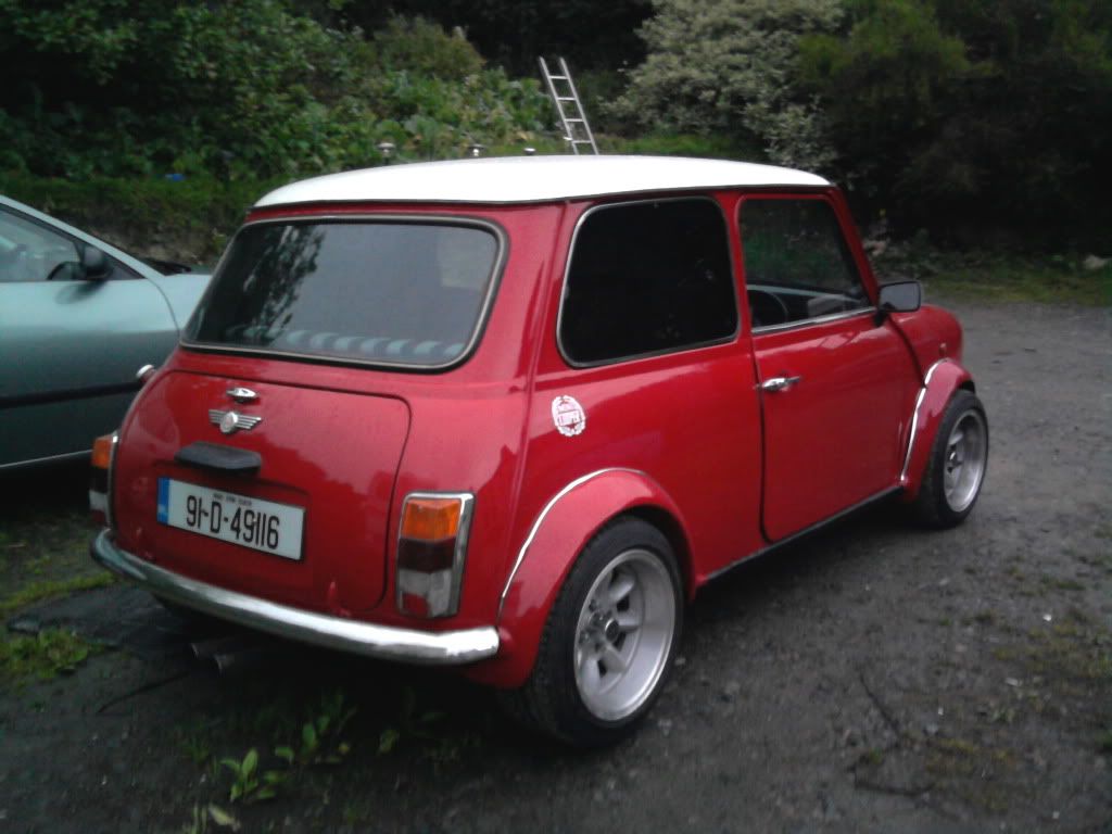

if you are going for 7wide then you will realy need miglia's, group 7's os sportspack etc. group 5's would be quite skimpy. i have sportspack on my mini with 7*13 and for my project i have miglia's and group 7's to choose from, im very indecisive so i got both haha. for 8*13 though group 7's mightn't do so it will have to be miglia's or possibly extra wide miglia's im not sure because i assume spacers will be needed.
some pic's to give you an idea....

i know what you mean, wasn't myself and still amn't too keen on them.... the miglia's i have don't have an internal lip but you buy angled brackets you can bond to the underside of arch or rivet on instead. the link are for the arches i got and i pic shows the brackets..... sold seperatly of course but im sure any brackets will do....

Sportpack's cover 7 x 13's very nice IMO
