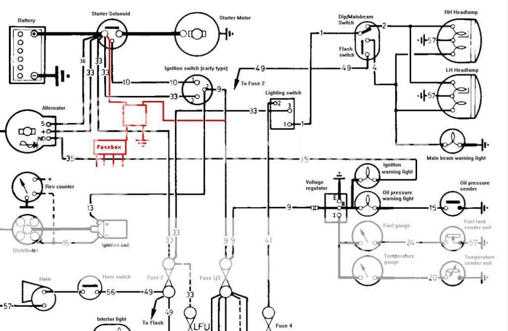

#11 Brams96
Brams96
  • 2,308 posts
Posted 16 October 2010 - 03:24 PM
Is your circuit something like this one, with the new feed coming from the solenoid, going to the relay and then to a fuse box for the new circuits? Are you taking the switched 12V from the ignition coil side or the other wire like shown?
