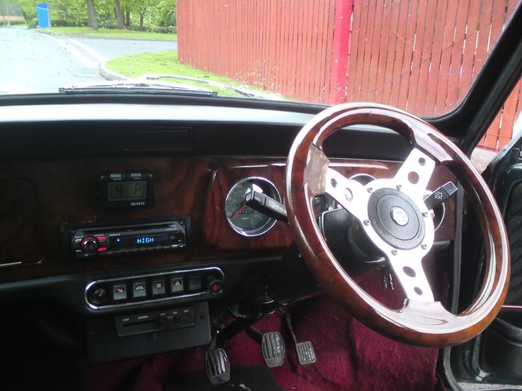

Description of problem: How do I remove a walnut dash from a 1993 Cooper?
Hi guys
Please forgive me if I'm repeating another of these topics but have spent ages searching for the answer on here and just couldnt find it.
Is there any chance someone has an 'IDIOTS GUIDE' of how to remove the dashboard from these little motors?
Here's the bar steward in question lol
Appreciate any help given.
Thanks peeps
Davey

if it's like mine look for clips on the bottom dash rail (looking up from the foot well) pull the bottom out and down and the top should un clip
you might need to remove the steering wheel
