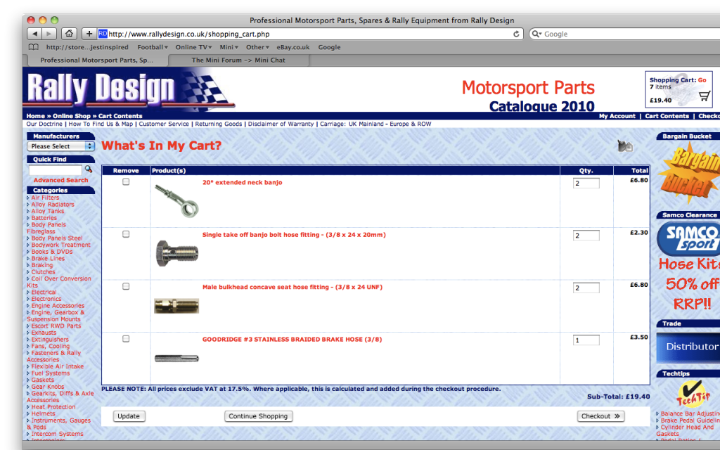

Just done a bit of research and as far as I can tell I need the following:
Does anyone know if this is the right fitments?
Thanks.

Hi, i recently ordered my fiesta caliper conversion hoses from BGC MOTORSPORT they provided a great service and i had my hoses delivered within 2 days for £32 ish.
The bits you need are :thumbsup:  2 x - 20 Degree Banjo Fitting, Zinc – 10mm – (5093-3P)
 2 x – Sealing Washer – Dowty Seal, Zinc – 10mm – (DW38U)
 2 x – Banjo Bolt, Zinc – 10 x 1.00 Thread – (992-32P)
 2 x – Bulkhead Fitting Female, 3/8” UNF Concave Seat, Zinc –(6001-3P)
 2 x – Stainless Braided Steel Hoses – 320mm – (600-3)
I found them on the net and they were the cheepest i could find, RALLY DESIGNS wanted about £50!
Hope this helps.
Andy.
